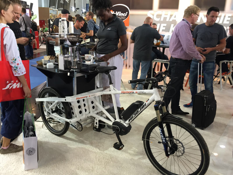

3. Re-body as something else. Coffee/icecream/crepes vending (much less regulation as no passengers).
