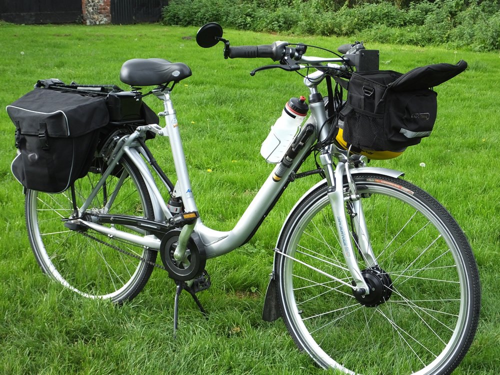

A few months ago there was some discussion on here about energy consumption figures, and what is considered 'normal'.
So, while I had my meter connected I thought I'd measure my (just over) 10 mile ride, just to see what I achieve.
The results surprised me a little if I'm honest.
I used 67wh over 10.5 miles, in 35 minutes. 6.4wh/m, average of 18mph.
I was pushing moderately hard, and got a sweat up, but even so I was surprised at how low the consumption.
To put it in context, I'm using a 21 kilo bike with 21 gears, slick tyres and constant current controller, mostly on lowest setting. Also, an old SWX motor.
What do others get in same or different circumstances? Would it be useful to start to record some data for reference?
