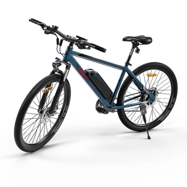

If that's what you want it for, a cheap electric bike will be fine. Look at the Eleglide M1 or M2. Note that there are different versions with different sized batteries, and some have desirable hydraulic brakes. Try and get one with at least 12Ah battery and hydraulic brakes. If money is tight, you can get a smaller battery, but when you get the bike, you might well want to use it for longer journeys, in which case the bigger one will be useful. I'm assuming that your weight is 100kg or less.

This not a bad advice, but... Eleglide are OKish bikes. My question still stands. Why to settle with mediocre choice when you can aim for excellence?
Eleglide is an easy fix. You click buy now and you get a bike. Easy and simple. What I offer is much more difficult. You would have to acquire individual components and convert bike yourself or pay somebody to do it, but end result would be much better. Your choice.
