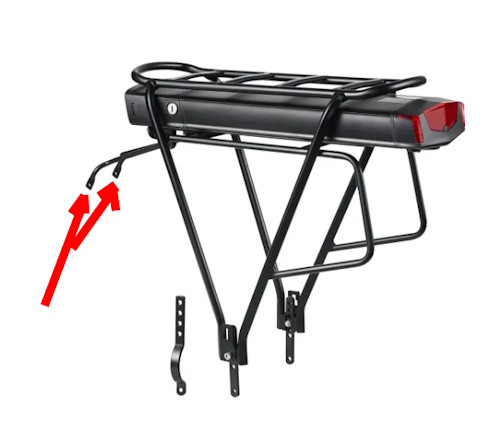

The original specs for that Giant say 7 speed at the rear which suggests freewheel.
Also, have you had a look at that frame? There seems to be no front anchor points for the rack.
I'm not sure where you would fit them on the PSWPower rack. What do you think?
