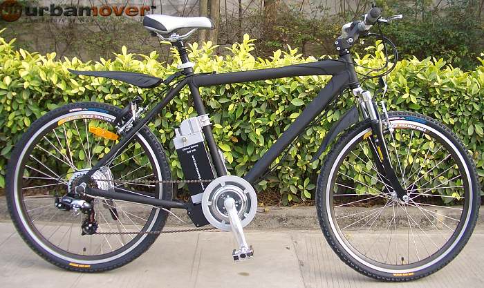

I got a pic of the new bigger frame UM36X:

Good to hear you've got your battery. That X model is a very smart looking bike, quite stylish.
