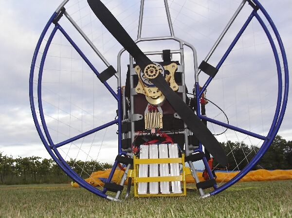

here a very exiting example from rc-modell-world:
here are even videos of it:
Mark's Paragliding Pages |Paragliding Videos|News|T-shirts/Merchandise|
this is a real, man-carrying paraglider, using a motor from rc-modelworld:
the motor weights only 1.5kg (so less than most bicycle-hub-motors)
power ? 17hp !!!! continouse
for short burst a lot more
so you see: weight can not be the only thing why you need big hub-motors..
when a 1.5kg light motor can do 17hp,
i guess a 150g light motor (1/10 weight) should do 170Watt (1/100 power) easily..
the problem is: RPM...
in a bike you need slow rpms --> tranny, gears, noise, looses, arghhhh !!!!
for that the hub-motors have benefits...
on the powerside at that low rpms they are realy weak
