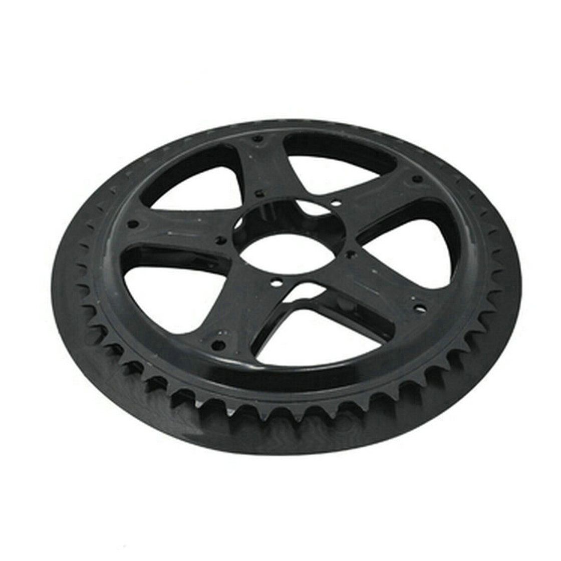

Motor is fitted and I definately need to change the front chainring for a smaller one. I also need to move the chainline inwards about 5mm somehow.
How do I get the chainring off as I can't see how to remove the black plastic chainguard and don't want to break it.?
21,163
17,227
the chain guard is the same on the Bafang BBS.
If you want to remove it, unscrew the 5 small self tapping screws at the back of the chainring.
42 tooth blingring would probably do that. I think 44 is the sweet spot on flattish roads say up to about 9% gradient. Once you get over that the double chainring is the weapon of choice.
My chainline is horrible but the chain falls off onto the inside chainring when I forget I shouldn't be changing gear on bumpy terrain. It will depend on your frame I guess.
