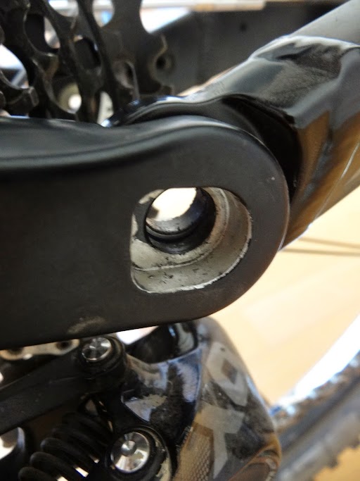

But today I've got another nasty surprize. My rear fork almost fell apart in a humble city joy ride. I didn't make it to mountains yet with this AMT bike! ;)
So the nut from the rear fork just broke apart like that.

As for the rear swingarm bolt.. These are reverse thread. Most users go to tighten it up. It then obviously loosens it (being reverse thread). They then tighten it back up having broken the threadlock seal.
There is nothing broken here, the bolt has just been loosened and therefore it has dropped out. You cannot ride the bike like this. You dealer should have a spare bolt to get you going again quickly.

It is a great bike and I enjoy it. Seller drove home to me today and changed the bolt. :)

The bolt is not actually reverse thread. It is however a normal thread bolt but its threaded from the inside of the swingarm. But Haibike put an Allen head within the bolt on the outside so it is easily accessible with tools. This then becomes reverse thread to the user when working on the bike.
As previously mentioned, if someone who doesn't know what they are doing, goes to check its tight from the outside, they will in fact loosen it. This then breaks the factory threadlock.. As this is a moving bolt it can then work loose pretty quickly.
This never happens if the bolt is not played with. Or if it has been removed, but then re-thread locked prior to assembling back together.

Hmmmm!. It doesn't make sense I'm afraid, Martin. No matter which side you insert the bolt from, you'd still undo it counter-clockwise from your direction of access if it's a right hand thread. It's only if the head were on the inside of the frame, but you were on the outside when you have to turn it in the opposite direction; however, everybody knows that.
Yes that is basically it! The head is on the inside, but you can turn it from the outside. The bolt is hollow and had a 6mm allen grip within it.
So just to sum up - The head is actually on the inside of the frame, but the user can access the allen from the outside..
If I get a chance I will picture one of my spare bolts of the frame, it will make perfect sense.

Still difficult to work out why such a bolt would be used.
Access from the outside could be achieved with an ordinary bolt.
Perhaps the threaded bit of the swingarm has to be on the outside for some reason.
I'm still not too impressed with a fixing for a pivot that relies on Loctite to stop it falling out.
Some engineers don't like that stuff at all, or would only use it to bolt one non-moving part to another.
