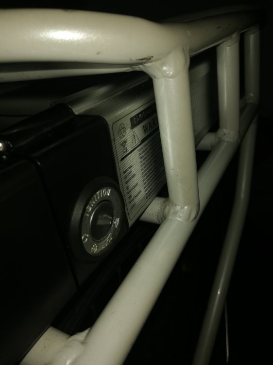

How do i connect my battery (48V) to my controller, using the leads in the picture?
One is hooped, the other is just plastic wire.
I have a sinking feeling the answer is going to be cut off and solder.
Is there an alternative ( i dont have a soldering iron)
Thanks!

Cut off, solder and heatshrink is the only solution. If you can't do it, you have to find someone that can.
It's not difficult to do. I can walk you through it if you get a soldering iron, some 60/40 tin/lead solder and heatshrink sleeve about 5mm diameter.
Don't bare any wire until you're ready. If they touch, there will be a big bang. You do one at a time.
Thanks!
You can use these if you have a hot air heat gun
https://www.ebay.co.uk/itm/100-4-Sizes-Solder-Seal-Heat-Shrink-Butt-Wire-Connector-Terminal-Waterproof-Kit/202731895782?ssPageName=STRK:MEBIDX:IT&_trksid=p2057872.m2749.l2649
