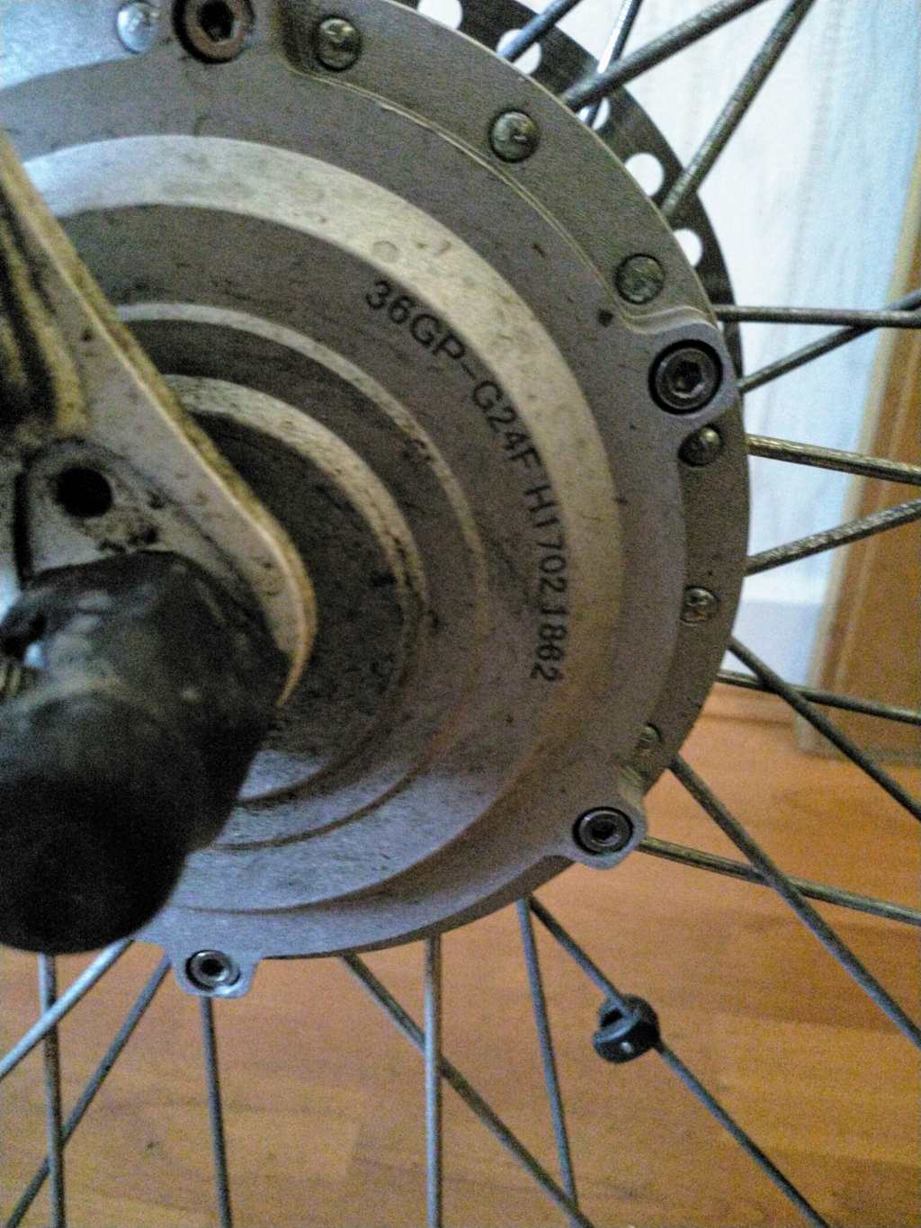

Hi All, can anyone help? I am a newbie to this ebike stuff but needed to install thumb throttle for help in my old age.......I have read the threads about converting my Carrera ebike to have a throttle, I bought the Kit consisting of controller, PAS, Throttle and LCD5 fitted to the bike wire to wire connections as the thread said, fired it up and set up the LCD5 with settings you will see below in pictures I have taken. Test revield nothing happens the motor gives a grunt when trying the throttle if I just wheel it backwards hold the switch then it runs.
The wiring is correct as per diagram supplied, the PAS distance between the magnets and sensor is 3mm (8 Magnets)
The only thing I can think of is it said the controller is suitable for 500w motor and the Carrera is 250w suntour but I thought bigger would be ok?
I am going to load the pictures of the install at the moment its looks rough but I will tidy this up when it works.
During road test nothing worked also If I switch on the battery then the LCD5 the battery shows full power in the display but the lights on the battery itself switch off, if I switch the battery on the lights only remain on for a few second?
Ant help will be much appreciated Kind regards To All Phill McCluskey
20230404_132454.jpg LCD5
20230404_132512.jpg Original Battery
20230404_132521.jpg New controller
20230404_132524.jpg Original Carrera motor
20230404_132803.jpg New PAS the gap is 3mm
20230404_134537.jpg The Settings I ahev used in progamming, Wheels are 700c, and set from KM/H to MPH

Hub motors rarely go wrong , only plastic gears and halls can go wrong.
With the halls there are only three Green, Blue , Yellow, the Red & Black are simply the 5v supply & Gnd supply for them and the spd sensor.
3mm gap from PAS sensor to magnet is far to great, for a decent signal it needs ideally to be 1mm or less so first of all get that sorted . You have two options remove the sensor from the bracket , place it on the opposite side and reverse the bracket so it is cranked further out or simply try and bend it over.
Next might be a setting issue with C1 as you are using a 8 pole disc then the value should be 00 or 01. If the PAS then works but only by A/C/W pedalling then one has to either reverse the magnet disc face or move rotate the sensor 180 degrees in it's current plain.
