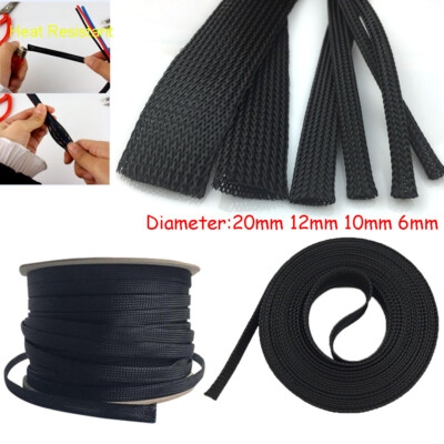

I used mesh cable tidy, the same sort used inside PCs. Protects thin wires within the cables from being broken by tight zipties, evening presssure over a larger cable surface area. I bought mine from Amazon, but it's a smidge cheaper on ebay.
