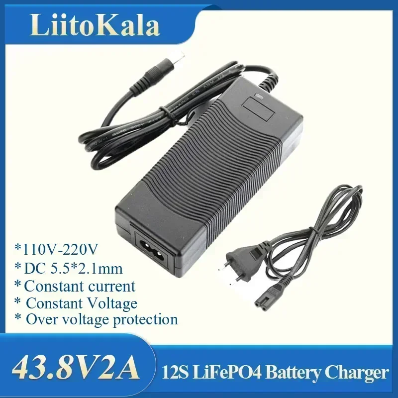

Yes I meant for setting up. I will of course use a dedicated lifepo4 bms as. In the case of a 36v pack It is possible to buy a 13s bms which brings the fully charged 3.65v cells to 43.8v but I have not seen a 43.8v charger for this?
8,853
3,974
Yes, I have a load of 36v LiFePO4 chargers. They're 43.8v for 12S, not 13S.
It's cheaper to buy two to get the free shipping, but if you search Aliexpress, you should be able to find one for around £10 with free shipping.
