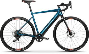

Now I’m seriously interested I really do like my carbon and think it would be relegated I’ll put a pic on and if you think it could be converted I would appreciate your thoughts?
it's quite easy to electrify a CF bike as long as you don't need crazy power that SW posted above.
A small battery can be placed inside a saddle bag together with the controller.
If you need more range, you can fit a small frog battery to an aluminium seat post.
I also have a torque sensor kit which is very lightweight, stealthy and built into the crankset.
21,540
8,789
It might be possible for CF bikes a mid motor is out as the BB build up of material around the ali shell is to larger unless the shell is push fit, then the material build up is likely to be too much.
A possible option might be a small light weight front hub like the Aikema 75/1.2kg, the 85/1.6kg or the Bafang G370/1.7kg.
