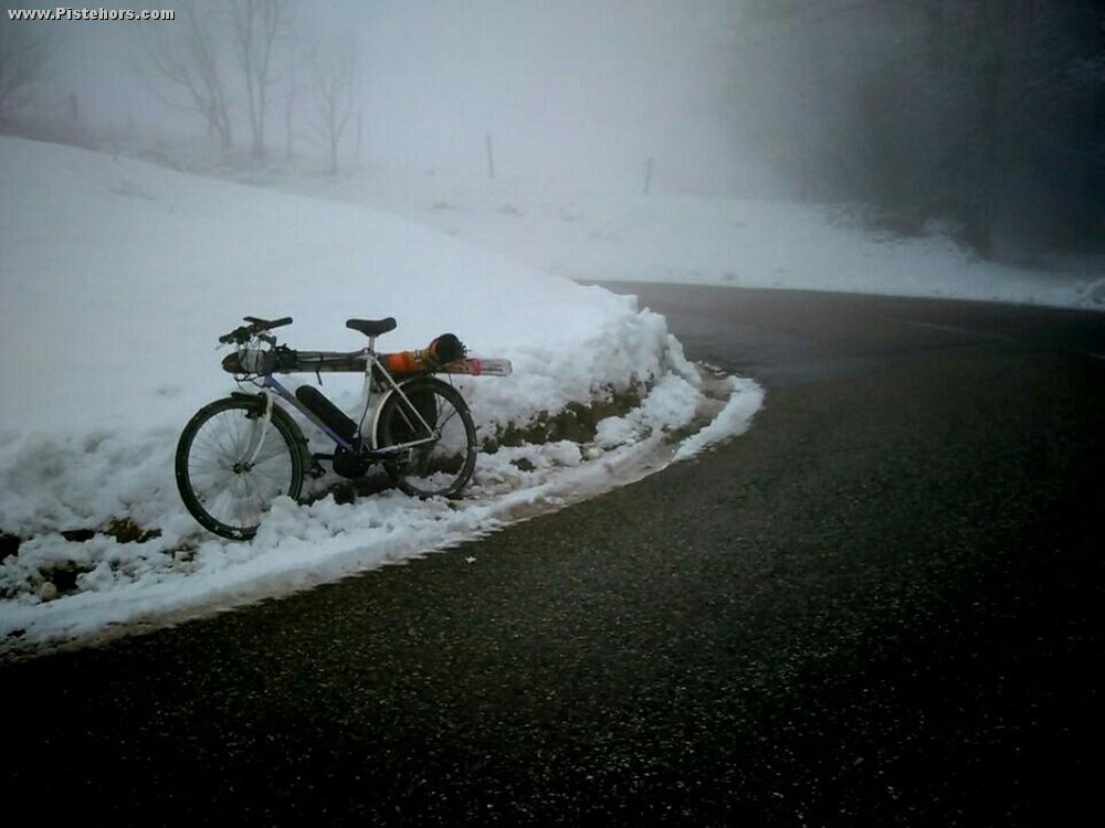

I clicked over 500km earlier in the week and now heading for 600km territory. Had a crank come loose one day, which is pretty common I hear do to the allen key bolts not tightening enough. Half of the riding this year has been in 30C + temperatures (afternoon commute home) so the motor doesn't seem to have too much problem with those conditions. Not many long climbs though and boy does the battery empty fast when you are pulling big amps.

Lovely pic.
Can you tell us where it was?

Lovely pic.
Yes, that's in the French Chartreuse mountains. If you want any better pics in the future PM me. I'm on about 900km at the moment as I've not been cycling much over winter as the roads are heavily salted.
