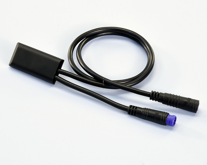

You don't say how far you need to travel? Any Bosch, Yamaha or Shimano steps crank drive will do with a speed-up device, racing bike style obviously so you don't stand out, more than likely you'll only need half power to cruise at 25 mph too.
An alternative to those is the Polini powered Bianchi which would probably be my choice.
They do an allroad version too which is cheaper, not checked what the difference is myself bar the obvious tyre difference.
Unlike the other motor manufacturers Polini have a refreshing attitude to speeding up their product too, although they don't state if there is a speed limit, I'm guessing it will give power to any speed, so a change to 53/39 front rings should do nicely to exploit the full potential if you find the standard top of 50x11 a bit low.

As others have said, reaching speeds of 35 to 40 mph even in the early hours of the morning are very likely to bring you to the attention of the Police so that's probably not a good idea. I like Artstu's suggestion of the Bianchi with the Polini motor and their Hi Speed device.
Apparently it fits inside the frame, I assume around where the battery is located and cannot be seen. This is unlike most of the dongle type devices that are on sale, so if anyone just looks the bike over they would not know it has been modified.
Obviously if you are involved in a serious accident on it then the accident investigation people would go over the bike with a fine tooth comb and soon ascertain that the bike had been modified. Traveling along at say 28 mph is not going to take that much longer than traveling at 35 mph, and its much less likely to have you pulled in by the Police.
