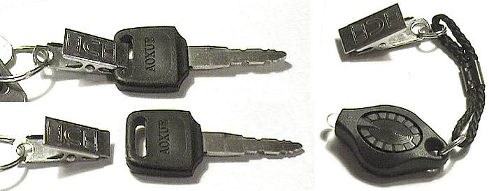

On a related note, what do you do with the ignition key? I can't remove it from the bike when the ignition is on, and I don't like all my other keys to dangle from the side of the bike, so I don't keep it on my usual key-ring. Nor do I like to leave it in the bike when the bike's unattended.
I have discovered the perfect solution to that problem. I've been using Photon Micro Lights for years, the Photon Freedom Micro is best keychain torches I've ever seen & owned (lifetime guarantee is nice too), one of the accessories for it is a lanyard with a clip on it, so I took the one off my older version (I use the Freedom Micros only now) and put it on my keychain:
Works like a charm! very difficult to accidentally or even intently pull the key out of it's grip so it's very safe on your keyring. PhotonLight.co.uk also sell them (I got stung with customs when ordering over £30 worth from the .com site a couple of months ago)
