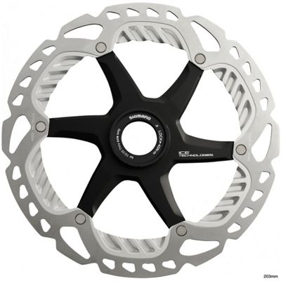

Look on the outer face of the rotor somewhere it should have resin stamped on the face, M315 set as will all the M xxx series right up to at least M525 will be marked resin and need resin/organic pads. If you want to use sintered/metallic pads buy Shimano icetech centrelock rotors cost about £20, they are secured by a central lock disc the same as a rear cassette.
