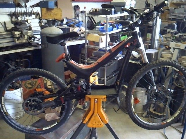

Hi,
I have been running a 360 second gen model for a while on a project bike max output 6kw , I have limited the nm output from the motor to below 130nm at the rear wheel sprocket input, so far all is well.
Bike and my weight 110kg.
Will not shift up under full load, as mentioned earlier in the thread, turn throttle down ,turn up gear.
Does down shift under load ok.
1 At least there's no chain crunching when chaining under light load or medium load.
2 chain bounce off road much better.
3 no derailer getting crunched.
Just my thoughts

Deleted member 4366
It's just a cheap Chinese rim from BMSBattery. 36 holes.

I can't tell properly from the photo, but what's the angle of the spokes like at the nipple? Mine's a 32-hole vesion btw.

Hi,
32spoke fairly good mtb rim , the spokes have taken some strain, but its ok so far
