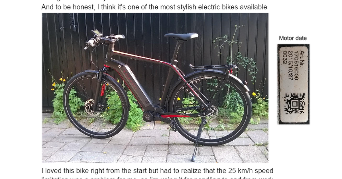

After 18000 km on my (2016) Kalkhoff with Impulse EVO RS motor, and sometimes failing pawls, I disassembled the engine and replaced the spring which presses the pawls into engagement with a more powerful one. (This I believe is the main problem on the Impulse motor)
Since then, there have never been any problems with the engine. It now runs after 29000 km still like butter.
I have made a report regarding this change which can be seen here if anyone should be interested
