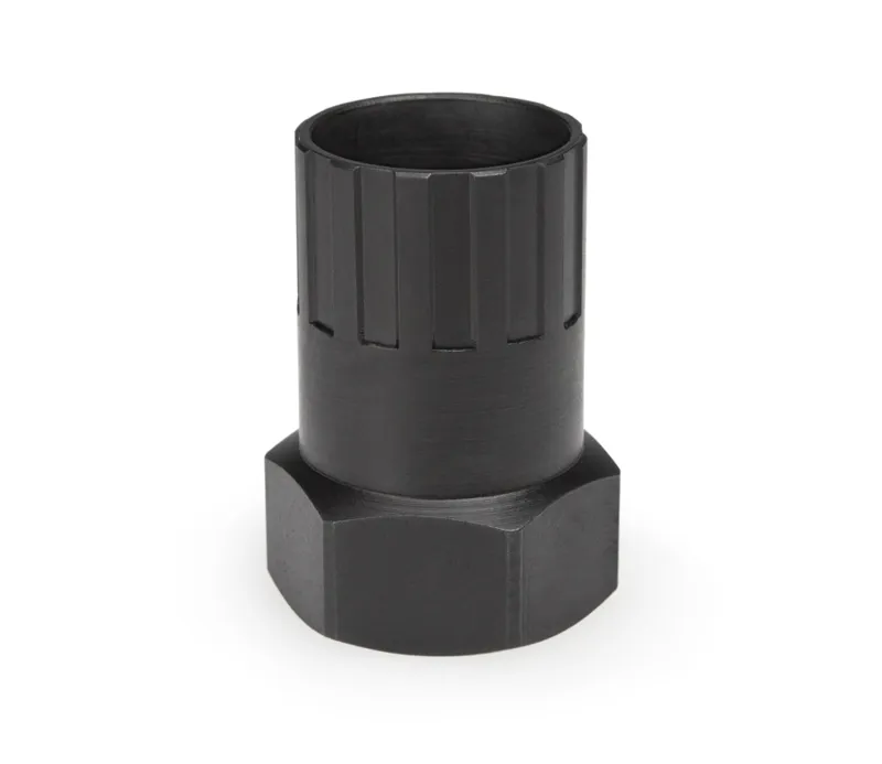

One thing to bare in mind is that you need to make the freewheel tool centre diameter is big enough to fit over the ebike hub motor axle. Here's one that will, they is probably others that do as well.
Reactions: Namwaldog
