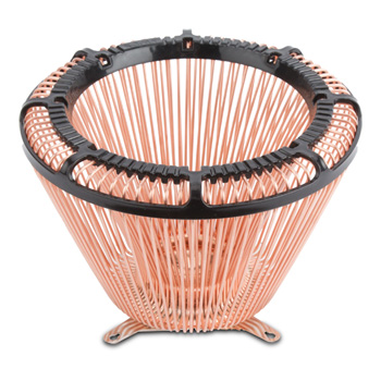

Passive CPU coolers made of copper can be pretty effective - totally silent, no fans, therefore less to go wrong. Like this one, which won't do me any good, because the databse and graphics work I do would cook my CPU with this attached.
... it'd supply sufficient cooling (depending on fanless case airflow) on a low loaded CPU on a media playback machine though (with a fanless power supply, and SSDs), if you want zero noise whilst listening to or watching Pink Floyd or whatever, without that annoying constant PC buzz. On the BBS01b, I'm starting to wonder if increasing the motor's surface area by attaching copper or aluminium heatsinks with long vanes attached to heatpipes...
..drilled into and meandering in and out of through the motor casing, would provide passive cooling worth putting in the effort to bother. Or heatpipes woven through the casing, and through a circular radiator running all the way around the motor... airflow would do the rest. Certainly more than it does now.
