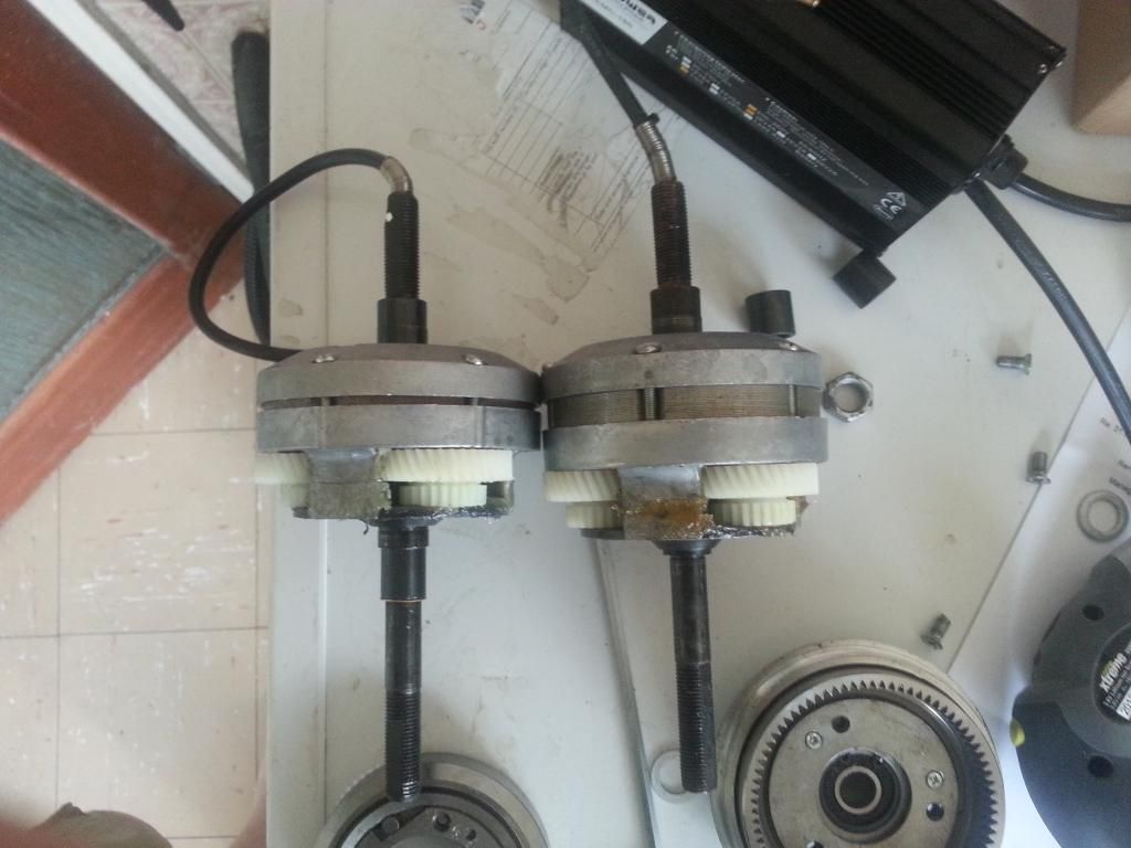

For those thinking about the Q100C motor, I stripped one down to compare with the normal Q100, and was surprised by the amount of differences, though the whole core and hub can be exchanged from one hub to the other.
Here's a photo that shows the main difference as the width of the internal motor. This must mean that the Q100C is less powerful.
