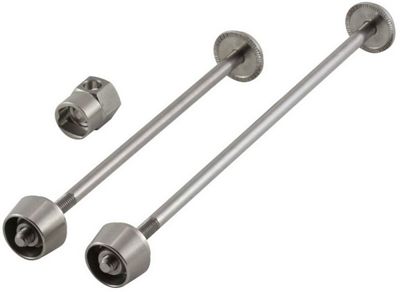

You can buy replacement skewers with Allen heads if you don’t want to spend a lot on the high security ones. Typically less than a tenner on eBay or amazon.
