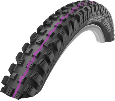

dh tyres would be a lot better but there not light.
20,139
8,231
60
As a solution you could carry a folding tyre with you.
