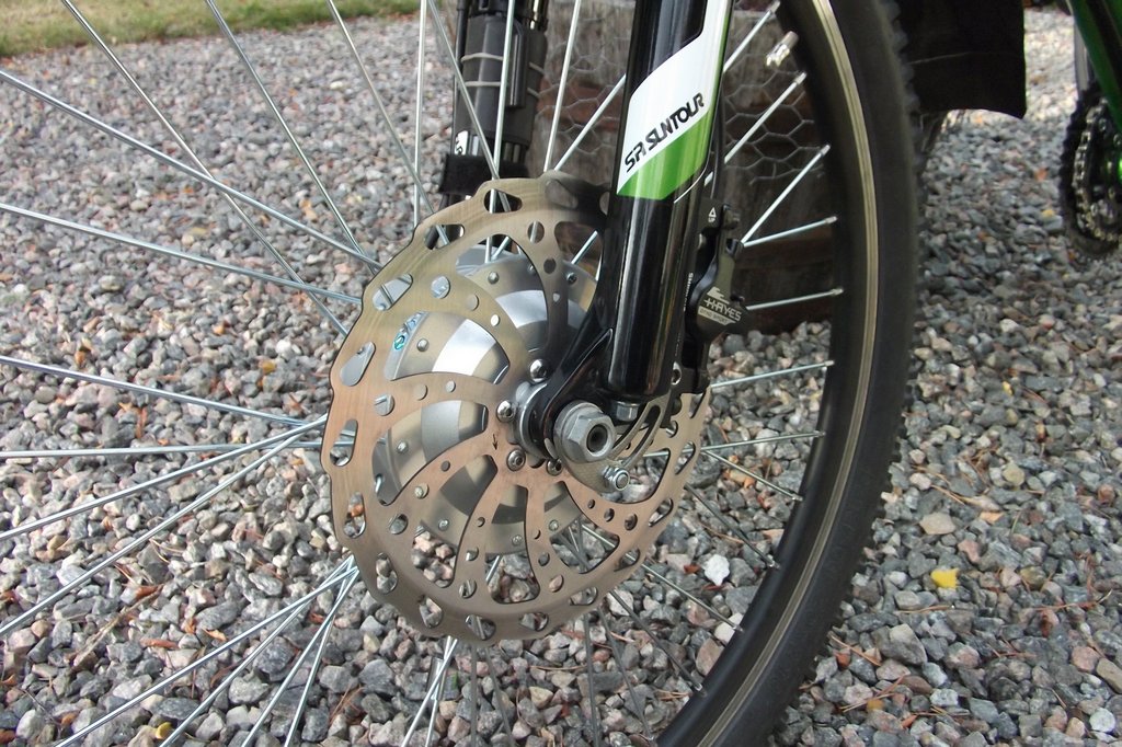

It's not very clear from the fitting instructions, I queried this with Cyclotricity when I fitted mine and it's the projection to go at the open end.
I had to do a bit of very careful filing of the forks to get the axle central in the slot, there's a thread about this somewhere on here.
Here's a picture of John's excellent torque arm fitted to mine, well worth it in my opinion for extra strength and peace of mind.
Dave.
