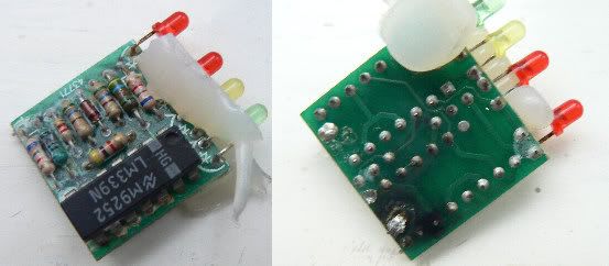

Tonight a miracle has occured. First I found the sensor still attached and tucked into the frame cover, reattached and reassembled with hope in my heart. When I turned the key, no power lights and no front and back lights. But I gave it a pedal anyway, just in case, and it worked! Well, the bike power worked.
So then I went back in and found a wire had broken off the controller chip that's behind the key - which presumably had fatigued free with all the on and offing of the frame cover. In the course of soldering this back on I shorted it and !bang! put it back together to put away for the night and this is the miracle part. Now the front and back lights do work, so does the bike, I'm just missing the battery charge indicators. Good enough for now!

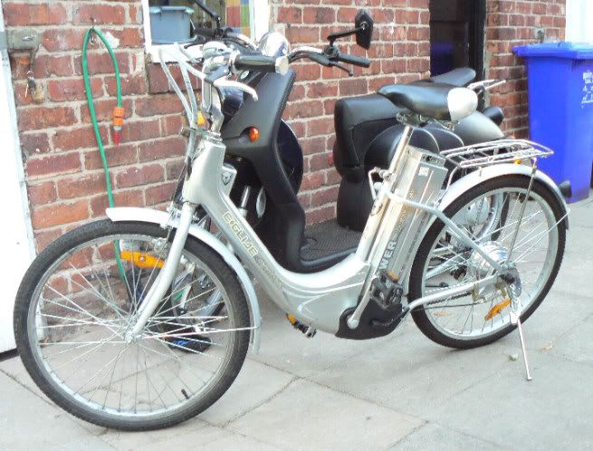

Photo's, of this jalopy? Well, if you like. Here's the bike itself (scooter behind might help you to reckon the size) one of the pedal sensor that got knocked off when the chain came off (circled blue) and one of the chip which when !BANG! but now the bike works without it. Although without the LEDs, obviously.

Thanks for doing that. It really helps to see the bike that is being discussed. Even that Jalopy. What an word Jalopy is. Great to here and say it again ...
I've been thinking of creating a new thread with a subject of "the only ones" so that we can list those members who are the only ones to have a certain bike. I think you might be the only member who has a Montana E-Glide! ...
