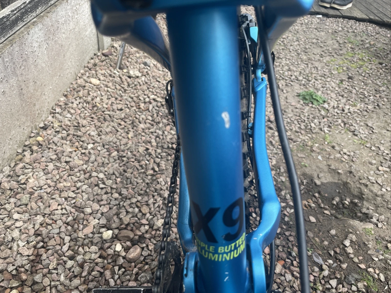

My Boardman MX Sport hybrid ( same frame as MX Comp ) are able to handle at least a 46t chainwheel ( i run an ofset 42t). There are more road focussed Boardman hybrid frames that run big chainwheels but less tyre clearance at the rear . Mine can just about handle a 1.75 inch width (700c/28 dia) at the rear (slight rub near mudguard bridge ) the hybrid comp frames I think a bit less.
The other thing to think about is downtube shape, the boardmans are not round but more a oval/ triangle shape, so ideally you need an extra rivnut alongside the bottle cage mounts. I also gave a couple of thick velcro straps on the battery for good measure.

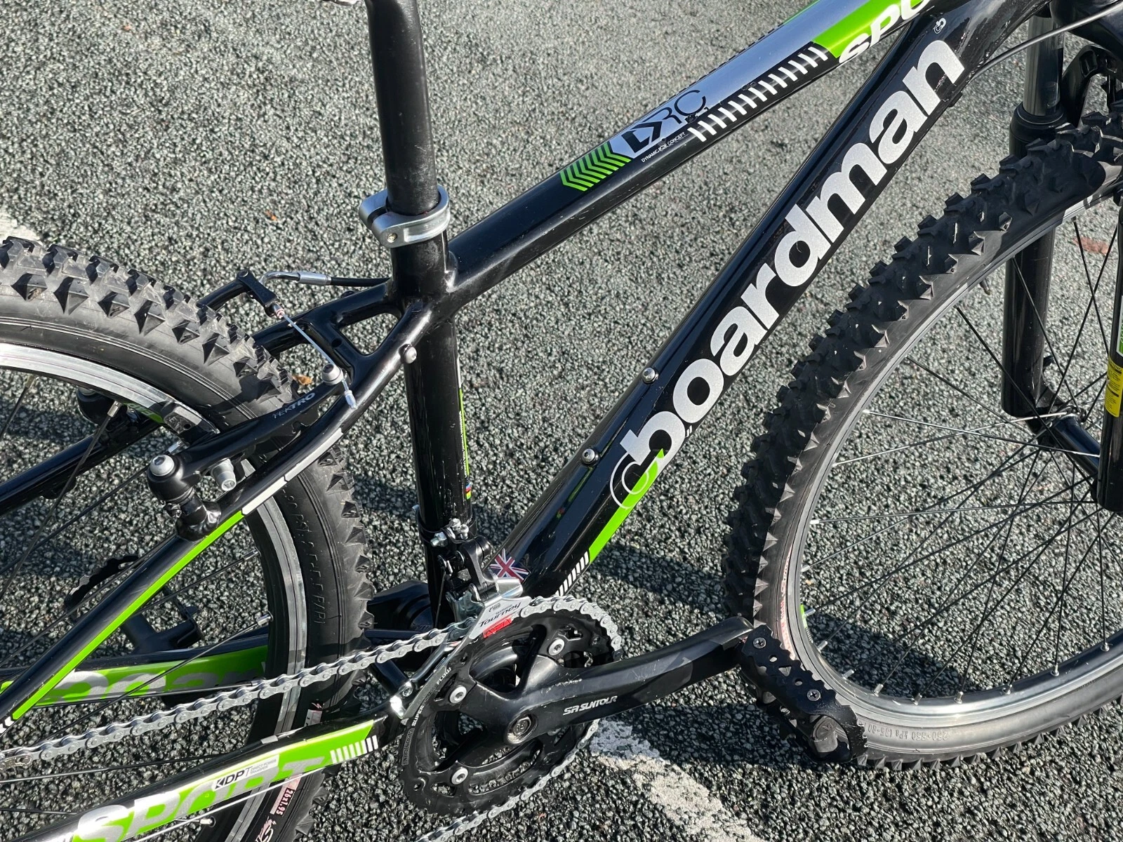

See what I mean by...
Looks like the chainstay tubes of some Boardmans have flattened sides, allowing a couple more mm clearance for larger chainwheels.
...on this "Boardman SPORT DRC 3XB Mountain Bike":
https://www.ebay.co.uk/itm/166668024146
...and on this Boardman full sus MTB (no room for Hailong downtube battery obvs):
https://www.ebay.co.uk/itm/166888199294
... also:
https://www.ebay.co.uk/itm/315465142466
I'd really need to see one in the flesh to be sure.
