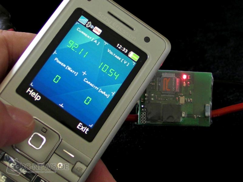

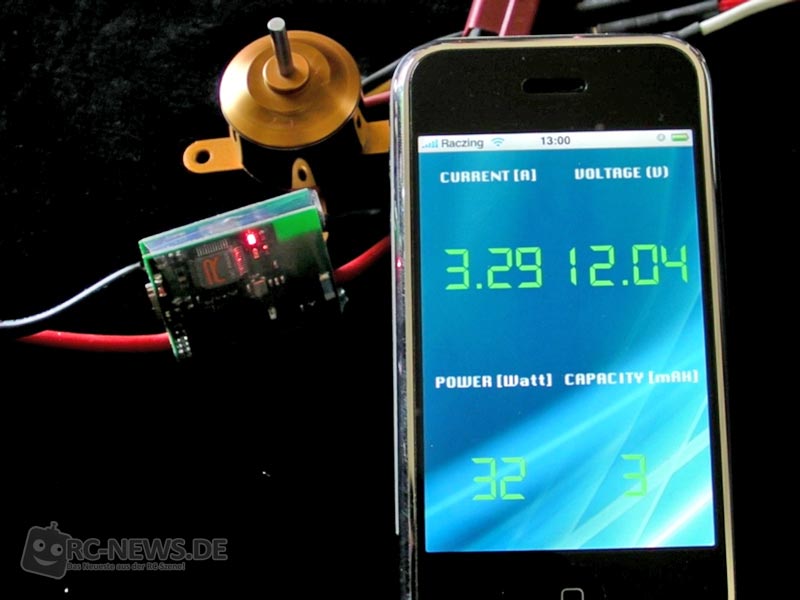

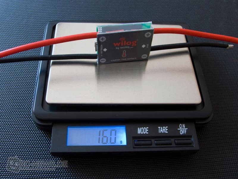

Hooray - my Raczing board finally arrived.
It sure is a small and neat little thing... Hardly there at all.
Took me a while to get the Java client working on my N96 - Turns out that there's a bug on the N96 which stops you installing Java apps if you have a card in the microSD slot - That was a fun one to debug.
Readings seem to match up pretty well with what the charger/discharger says too.. Volts are bang-on... Amps are a little bit out on one device.. but I couldn't guess which one.
