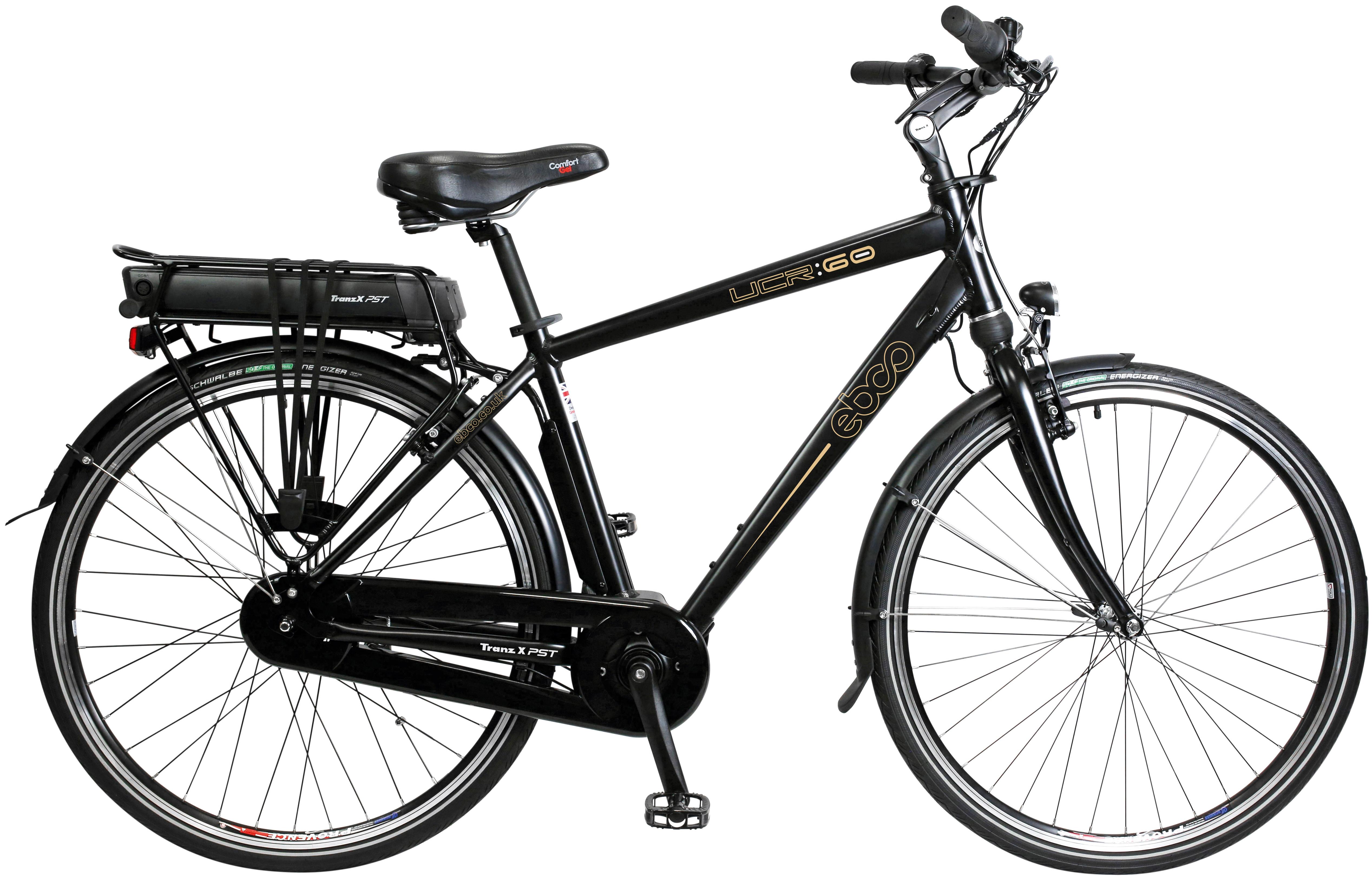

Ebco USR55
Ha, full mudguards with stays & a chain cover:).
Going a little OT here...
In the distant past (1984/5) I was a bike assembler in the long since demolished Raleigh factory 2. Those mudguards were a right pig to fit on a moving conveyor with a bloke opposite doing the bottom bracket. Some of them were considerate but the majority just slammed on their pneumatic jibbyjobber to nip up the BB sending your minute nuts, bolts & washers flying everywhere :mad:
Getting back on topic, I think I'd prefer a crank drive. Pros & cons with both I guess.

You must be looking at the wrong bike... £1099 (deduct your employer discount?)

The Ebco hybrid is rigid fork so a no, but the MTB is suspension.
I'll nip out to have a gander in Halfords now, quite a few choices.
The Ebco USR-55 has TransX headstock suspension. It gives about 30mm travel, which I'm finding perfectly fine on road and trails. Yes, a NEX fork with 63mm and lockout (as my MaxDrive bike has) might have been a little better, but my view is you can't be too choosy given it's a decent crank drive motor with 10-speed Shimano Deore gearing and hydraulic brakes for a tad over a grand. The Ebco MH-5 MTB version has fuller Suntour forks, but compromises on other parts, given it is the same price.

Final advice not to buy any bike with a non-standard crank motor. Stick to Bosch, Bafang and Shimano if you must have one. Only the Bafang can be fixed by yourself. What seems like a bargain now can turn into a dead loss in two years time, or even before that.
Reactions: Audio2
cyclebuddy
Nov 2, 2016
1,662
778
Beds & Norfolk
Says the rear-wheel-drive King (whose knowledge and advice I respect enormously - except on this)!
There's nothing non-standard about a TransX M16 GT mid-drive motor, except nobody on this forum knows much about it. And that might well be because no-one has had any issues with it!
Given Raleigh, Diamondback, Ebco and a host of European and American makers have been using it for years (since 2014?), and there aren't many - if any - problems of note found if you Google extensively suggests it can't be bad at all. Even EBR loves this motor on comparable iZip bikes!
As with all the common mid-drive motors, if it fails, it's a dealer issue. But it comes with a comprehensive 2-year warranty and dealer plug-in Can-Bus diagnostics, so, no, I'm not concerned. And at a grand-ish? Where's the problem?
If mine fails, I'll be sure to shout about it here and eat humble pie.
