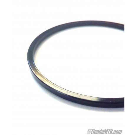

hope everyone is well, been very busy lately but the modifications to the cog are finally underway. annoyingly though i have strange wear marks on every other tooth of the new sprocket i think thats why im feeling a buzzing in the frame (it is not audible only felt)

that spacer is way to thick as the sprocket is pushed to far out.
indeed, im grinding it down by hand as we speak, it takes longer but i dont want it to thin as i want to make sure the lockring will compress againgst the sprocket

18
any ideas about the wear marks in first pic? it must be from the inner links but it never happened on the original cog, chain is kmc e11 so it should fit fine, maybe it is wearing in but still srange

it is just the paint coming off they will all go like that as i have 2 with the same wear on themDSC_0166_02.JPG

possibly as i have rode around 40 miles without spacer and so it was loose, not shredding or anything just slowly cruising down the road to the local shop, not going to any trails till its fitted properly, funnily enough when its loose it stays inline with each cog as i change gears, maybe they could design a sprung soacer or a mechanism tha keeps it inline with each gear hmm..

when i run 2 sprockets on the front i have to use a brass washer in the ses wheel so it can move in and out.
and dont ride it if it is loose as you will damage the splines the sprocket fits on 2.
