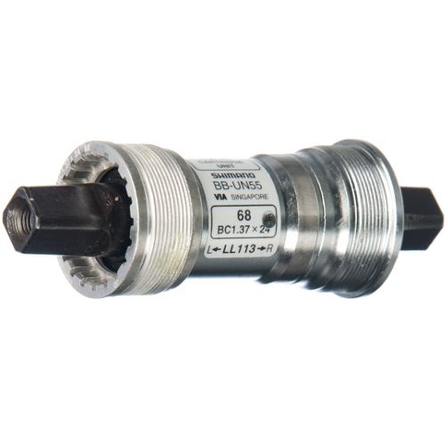

this is the kind of bottom bracket (BB) fitted in your Big Bear:
Shimano UN55:

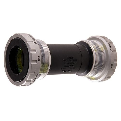

This is a BB for Hollowtech:
Shimano 4600
The bearing cartridges are inside the BB shell in the Big Bear, they are outside the BB shell in the Hollowtech.
