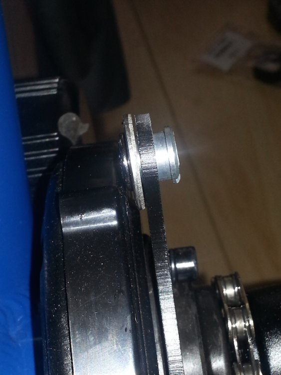

Actually... I've just tried to fit the bracket and it seems the chainring bolts hit the motor! It throws the chainline so far out of sync with the rear mech, that it only works on the top three gears on the rear sprockets. As you can see by the pictures, even if I mount the chainring bolts on the inside of the bracket (which is not the correct way) there is still not enough room as the bolt would hit the motor. Any ideas?
