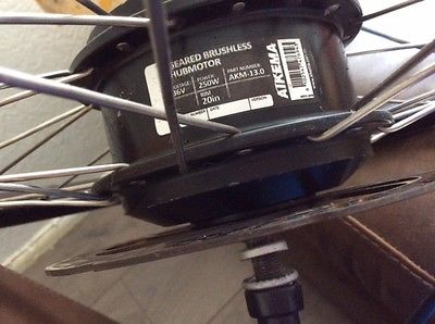

This is what I've got. So it's a sensor motor? Everything seems run ok apart from the motor seeming a bit noisy and rough. I took it out today on a gravel path and a couple of times the front wheel lost traction and slipped and then the motor would cut out and require me to stop pedalling for a second and pedal again to get the PAS to kick in again. I thought the P1 setting may help these things Sent from my NEM-L51 using Tapatalk

Ok as best I can tell it is about 125mm diameter (4.92 inches). I also found it carries a code engraved in the motor bbz3620a. Not sure if this helps? Sent from my NEM-L51 using Tapatalk

Does the photo I provided in my original post not give this information ? It is labelled aikema akm-13. I have no idea at all how to determine whether it sensor or sensorless. Sent from my NEM-L51 using Tapatalk

Hi there I have now received this motor but I think my kt-lcd parameter needs some adjustment. I am trying to determine the correct P1 setting but I don't know how to find out the number of alnico magnets. Any pointers? Sent from my NEM-L51 using Tapatalk
