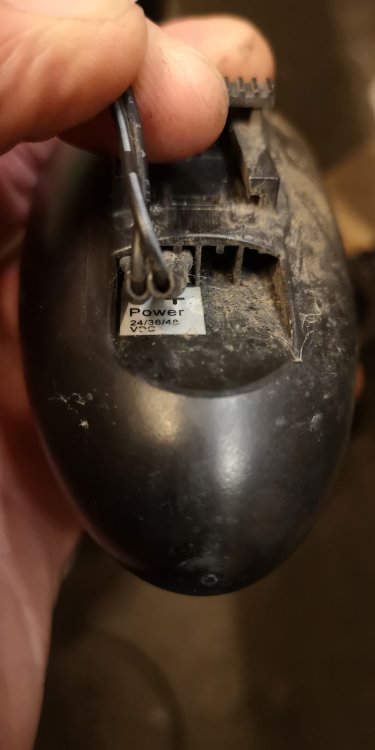

  1. Good morning all, my bikes lights have stopped working and I suspect this little box as the problem, ideally I like to replace it with the same but not sure what is or where to get a replacement? As the light says 24-48v I presume it's just a relay thingy rather than a voltage dropper. Any help would be gratefully received-thankyou Mark

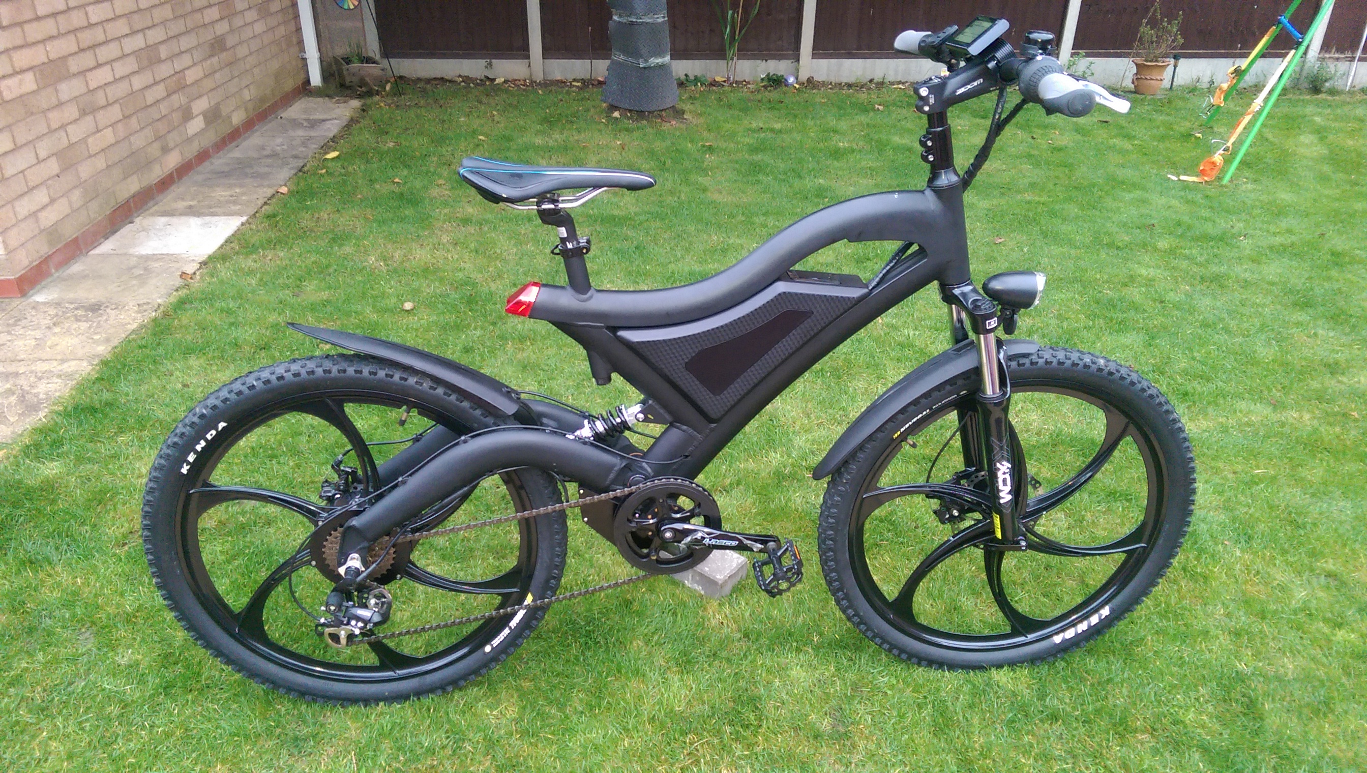

  19. Hi, yes the headset looks almost vertical which is partly I guess why it's such a long stretch to the bars. I tried to measure it and my best guesstimate is 13.5 degrees from a vertical upright using a spirit level. Strange that the frame description is as follows.. 6061 aluminum alloy, design based on human I'd like to meet the human they based it on
