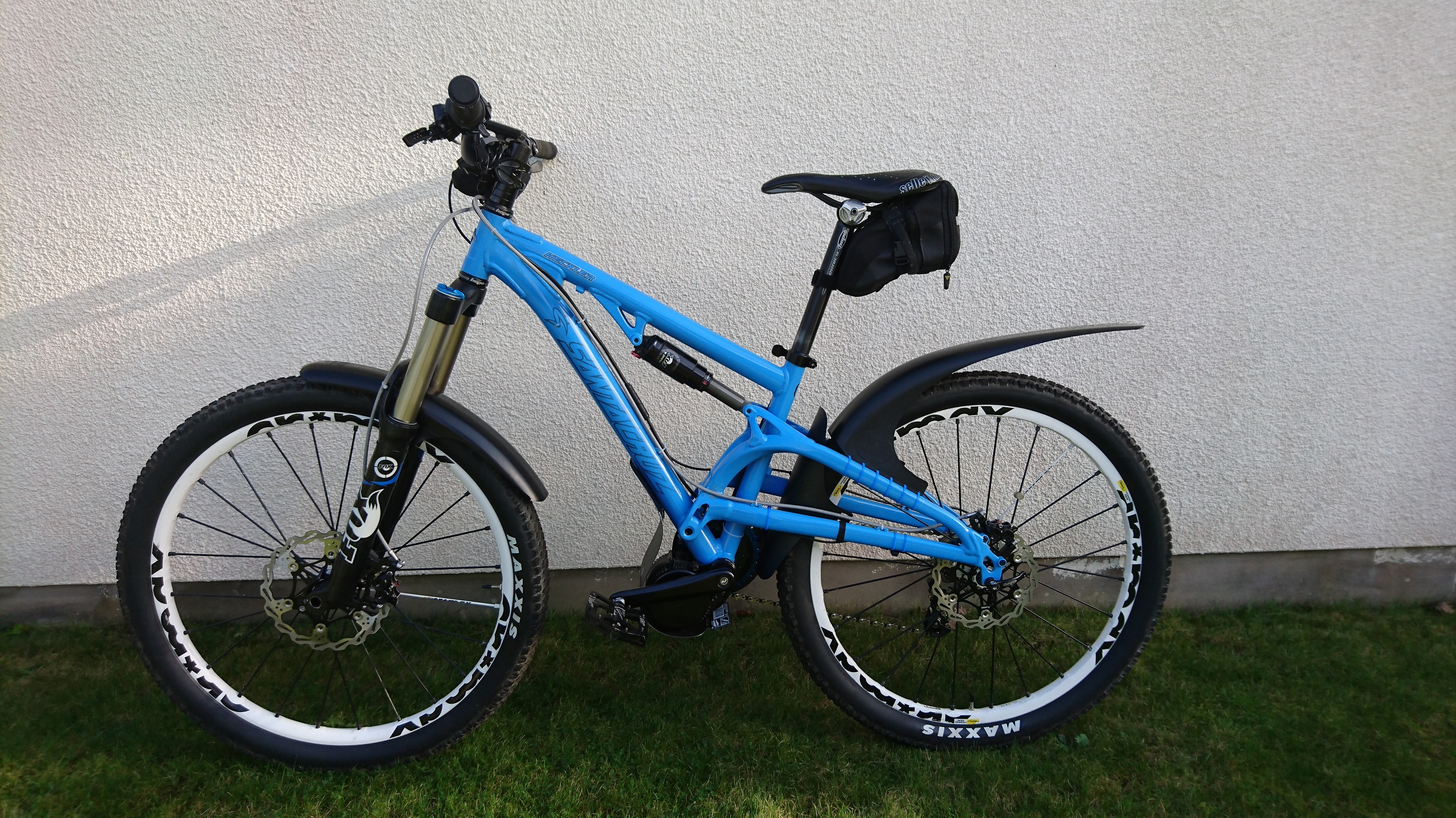

  11. Another build as I've been missing my hardtail bike after selling the Cannondale SL1 Lefty...frame bought in the CRC sale for £160, the rest is from garage spares...Fox Factory 34 CTD forks, Mavic Crossmax WTS 275 Enduro wheels, Hope Tech3 E4 brakes (203/180), etc, etc...top speed on the flat is 39.1mph (according to Strava) running a 60V~ (full charge) battery with a 30ish mile range, but after getting used to FS bikes over the last few years it is a nightmare to keep in a straight line at speed on the trails...the colour combination has prompted a few favourable comments whilst out, although I'm a bit unsure about it myself.
  12. Thought I'd update on my recent builds...this one is for friends to use when they come over...Santa Cruz Heckler 6 in Club Tropicana colours with a 36V 250W BBS01B (nice and legal for the haters out there) and 17Ah GA celled battery. It's been upgraded with Fox 36 160 TALAS RC2 forks, Crossmax SX wheels, Hope Tech3 E4 brakes, etc, etc...we took it out a few weeks ago at Coed y Brenin and rented a new Trek Powerfly 9, CX motored eMTB to run with it, the Trek struggled to keep up and ran out of battery 10 miles from the end of the 30 mile-ish Dragons Back run...and it was twice+ the price of the Heckler build!!
