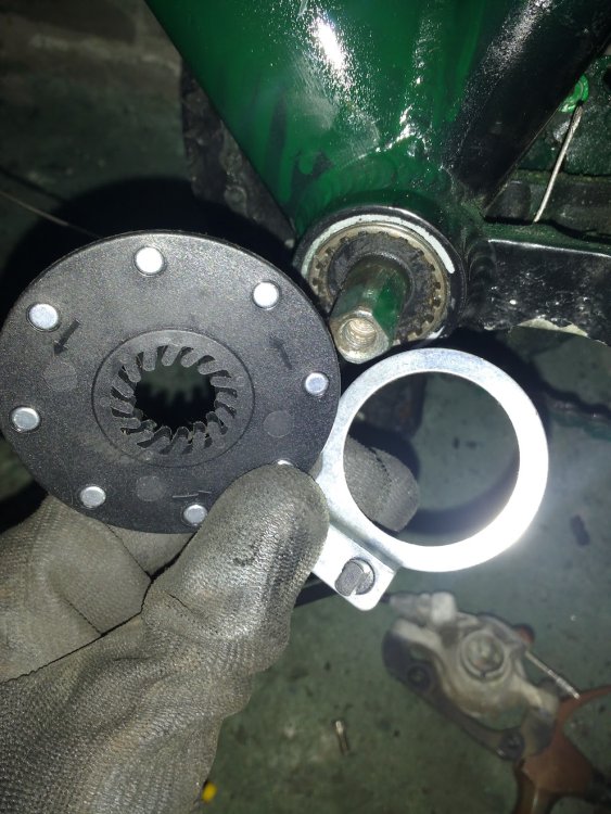

  4. the directions from the kit seller said to put it on the non drive side... does it matter though? do the silver circles need to be pointing at or away from the sensor? Does it matter as long as the arrows on the disc follow the same direction as the pedals go?
  5. How do i install this? I have watched multiple youtube videos but they must be different because they say that i need to unscrew something, place the metal sensor down, rescrew something and then place he magnetic bit.. I dont have anything to screw onto the sensor part. Ive included links to some photos to see what im working with
