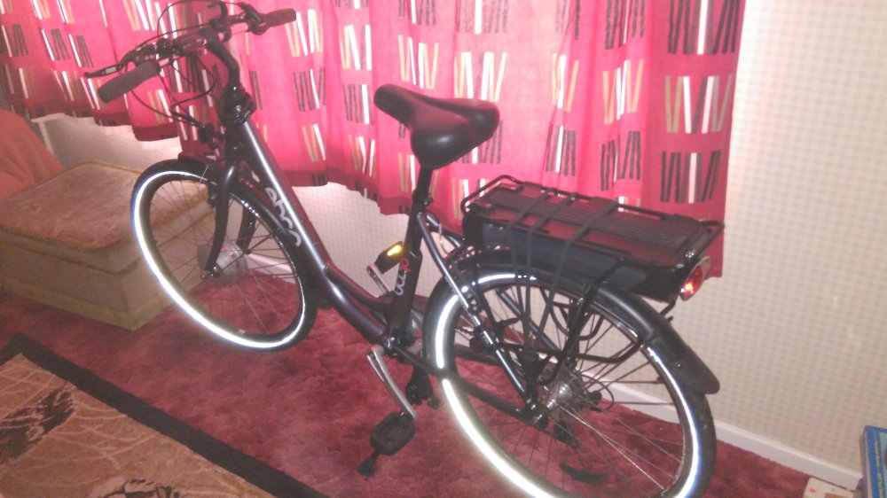

  1. My as new ucl 10 is for sale due to my disability where I cannot pedal for more than a minute or 2. I am looking to sell this one and repurchase a 500 watt bike with a throttle control etc. The ucl10 is genuinely in an as new condition , I have replaced the dutch handlebars with straights but the dutch will go with the bike as well when sold. The whole unit bike , battery etc is only a few weeks old to me as I purchased it from a shop where it was a demonstration model. In absolute perfect order see photos. I am looking for £550 or an extremely near offer. I still have the original packing and box which I can use for YOUR carrier company. The bike can be seen and tested in Gimingham North Norfolk. The bike has full size mudguards , front and rear lights , chain guard , good tyres , reflective wheels and pedals , double legged stand , see ucl10 specs online. Please contact me via the forum or phone 07979516033.
