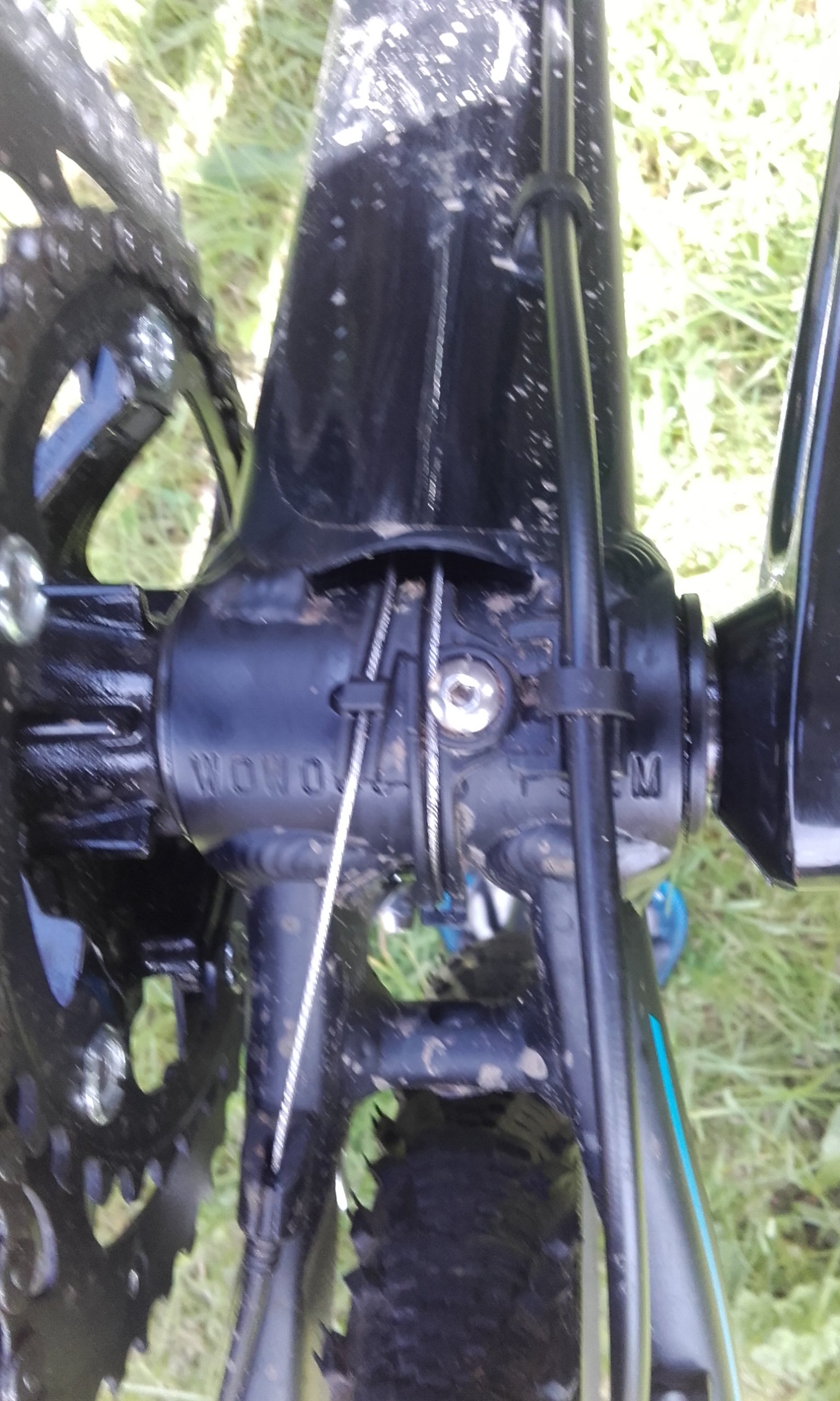

  3. is this ok with the wires cable tied

  11. yes not finished yet just wanted to check gap was ok im using spare thin cable ties i had lying around il go round putting cable ties you gave me once it up and running
  12. this look ok next to brake cable
  13. this look ok and bring it up and under crank housing

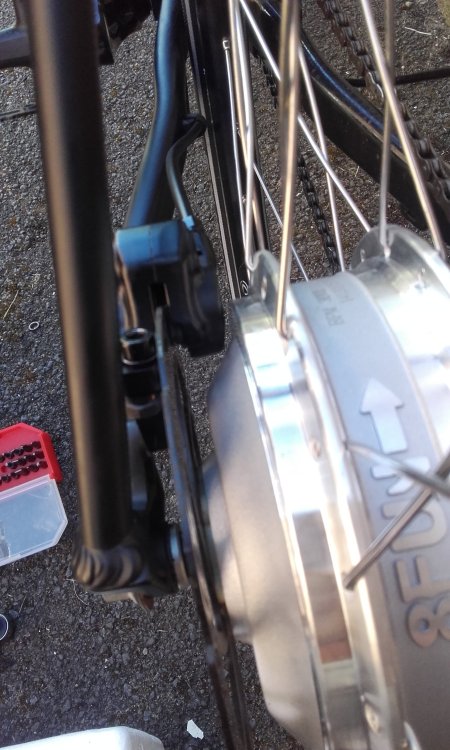

  18. thanks reply just gona wait dry up and go start again il take some more pics.

  20. hi ive started my build ive had to do a bit of tinkering the rear caliper kept hitting the hub. and disk woudnt line up ive packed disk with spacer that came with wheel is that ok., ive filed abit of the hanger to make bit clearance to the hub. and the battery hits the chain so i need to drill and put new riv nuts in am i correct there m5.
