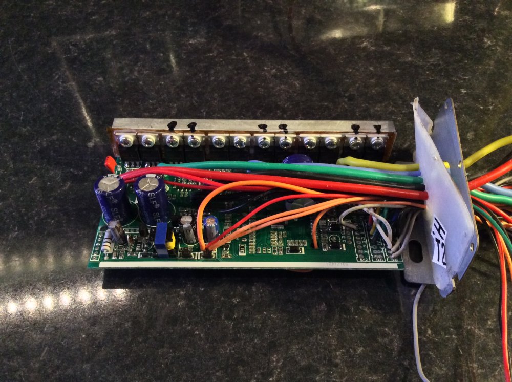

  2. The 6 mosfets I’ve marked in black do seem to be faulty, I tested them incorrectly last time using my negative lead on the gate / drain and positive on the source when, as I did in the first place, it should have been the other way round. There is no power from Gate to the Source whereas on the other 6 there is. So.. any chance anyone has info on these conductors as a replacement? I can’t find any info but they did come out of a 110amp controller.

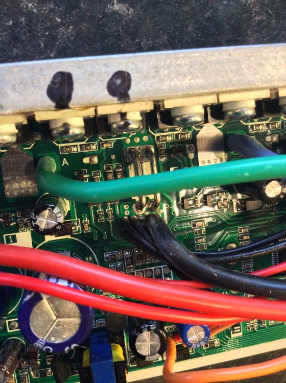

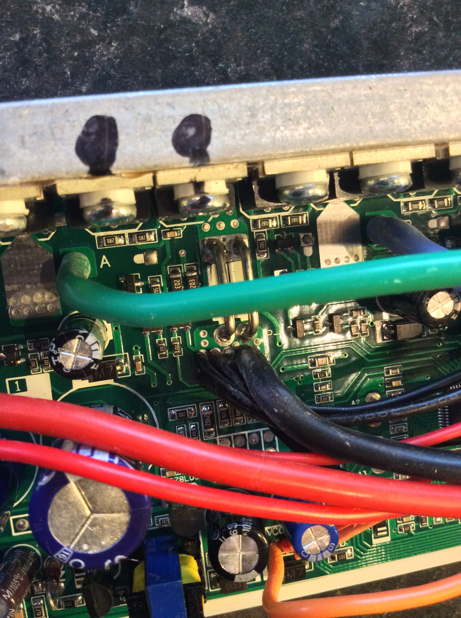

  4. Just noticed this on the back of the controller, this is the soldered joint where the negative lead comes in from the battery. Would this be an issue?
  5. Could the phase wire sequence go wrong? Everything was working ok before this happened and I hadn’t had anything out or changed any settings etc. The only thing I was doing was transferring the battery from this to my daughters buggy and back again. The controller has never been moved, it is in a sealed off area to the rest of the scooter. I’ve checked for loose connections but I can’t see any. Out of the 3 main power wires to the motor the middle wire ‘green’ seems to draw a higher current as it gets very hot. Looking at the back of the controller the soldering is a cheap looking messy job.

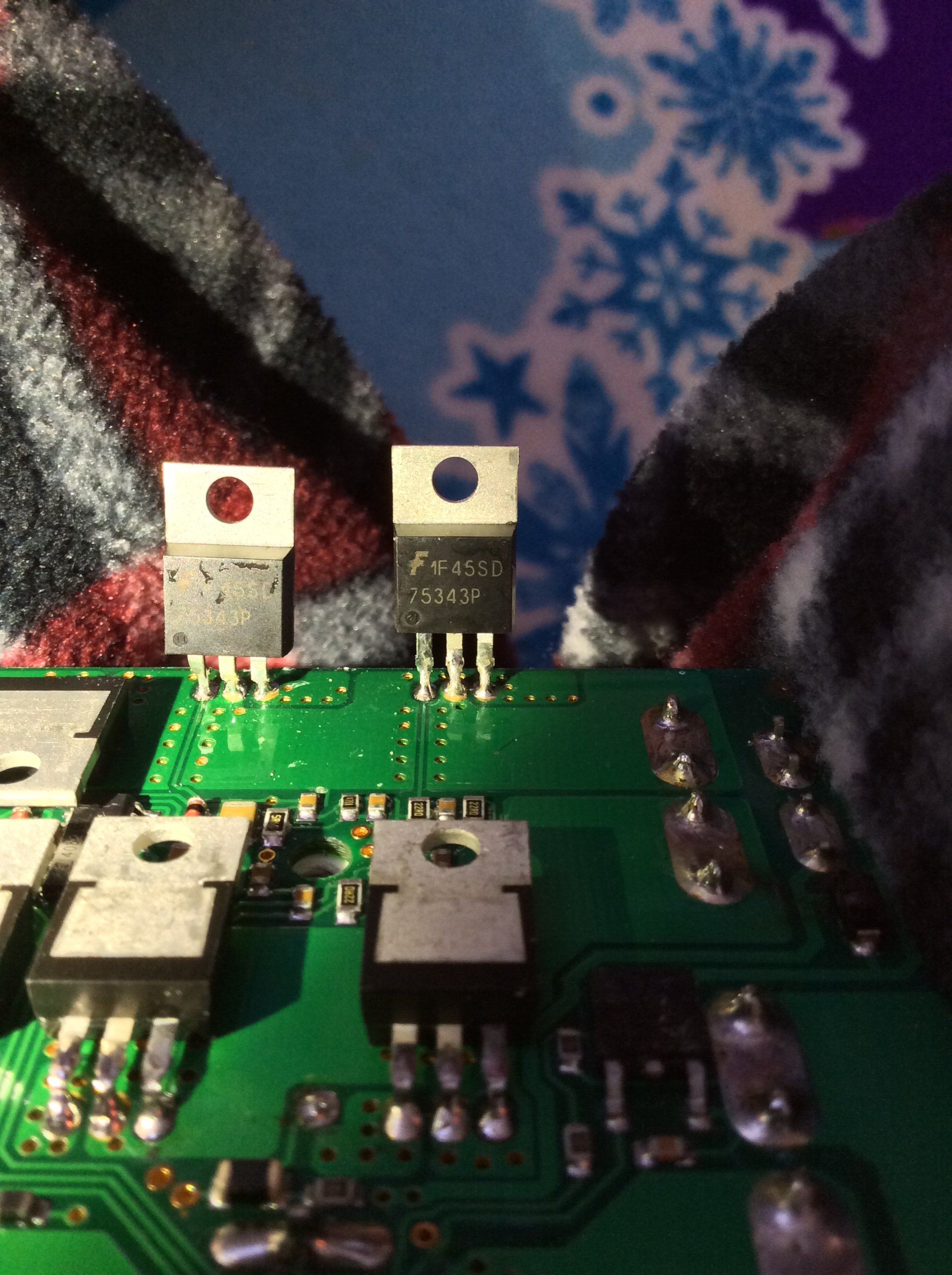

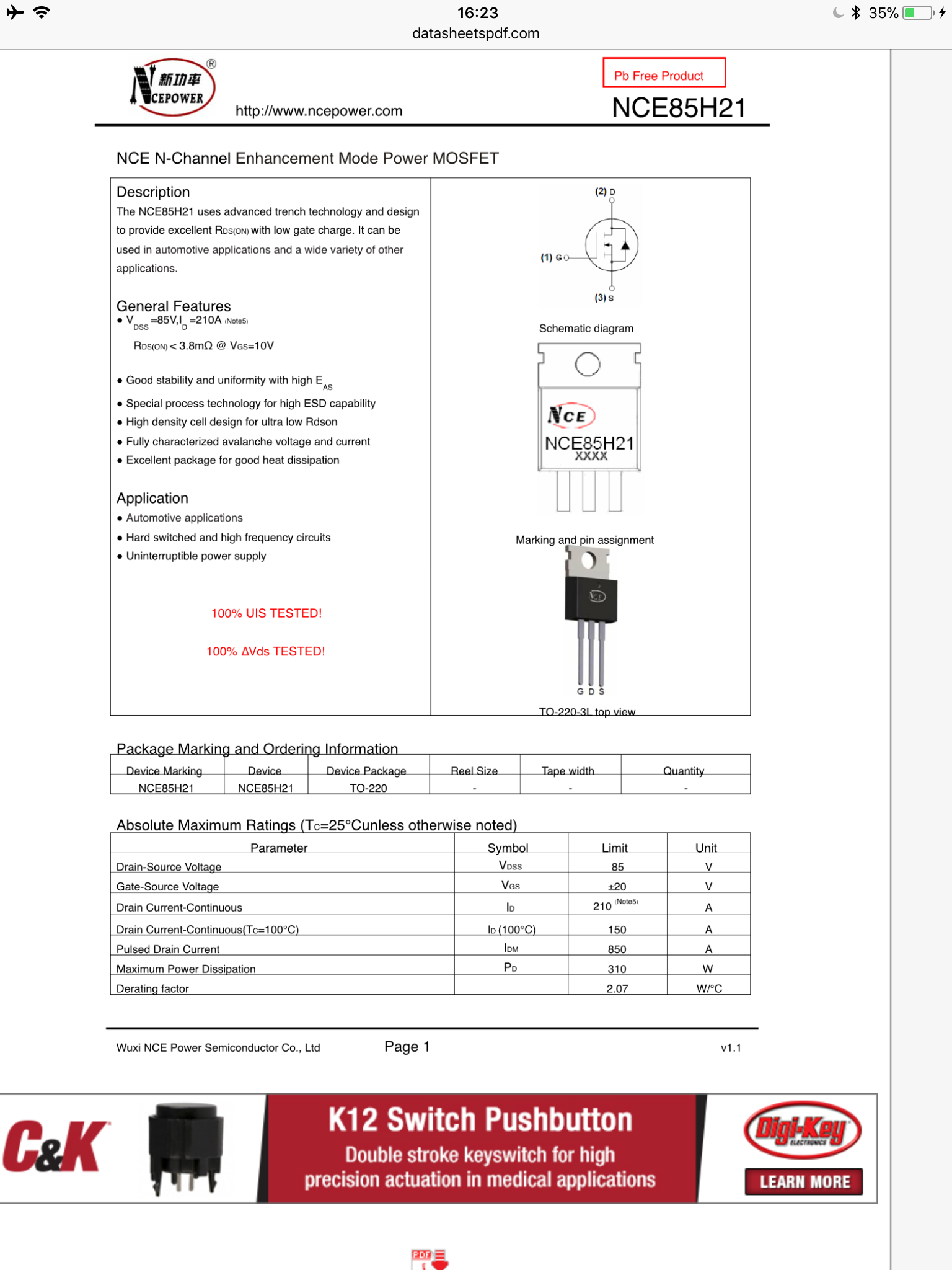

  7. Hmmm, so they might work but aren’t necessarily suitable for this application? I’ve also a full set of the mosfets in the picture below, they came out of a 24v 110amp controller but I can’t find the specs on them anywhere.
  8. These are the ones I have spare These are the existing ones. I’m not too clued up on the difference

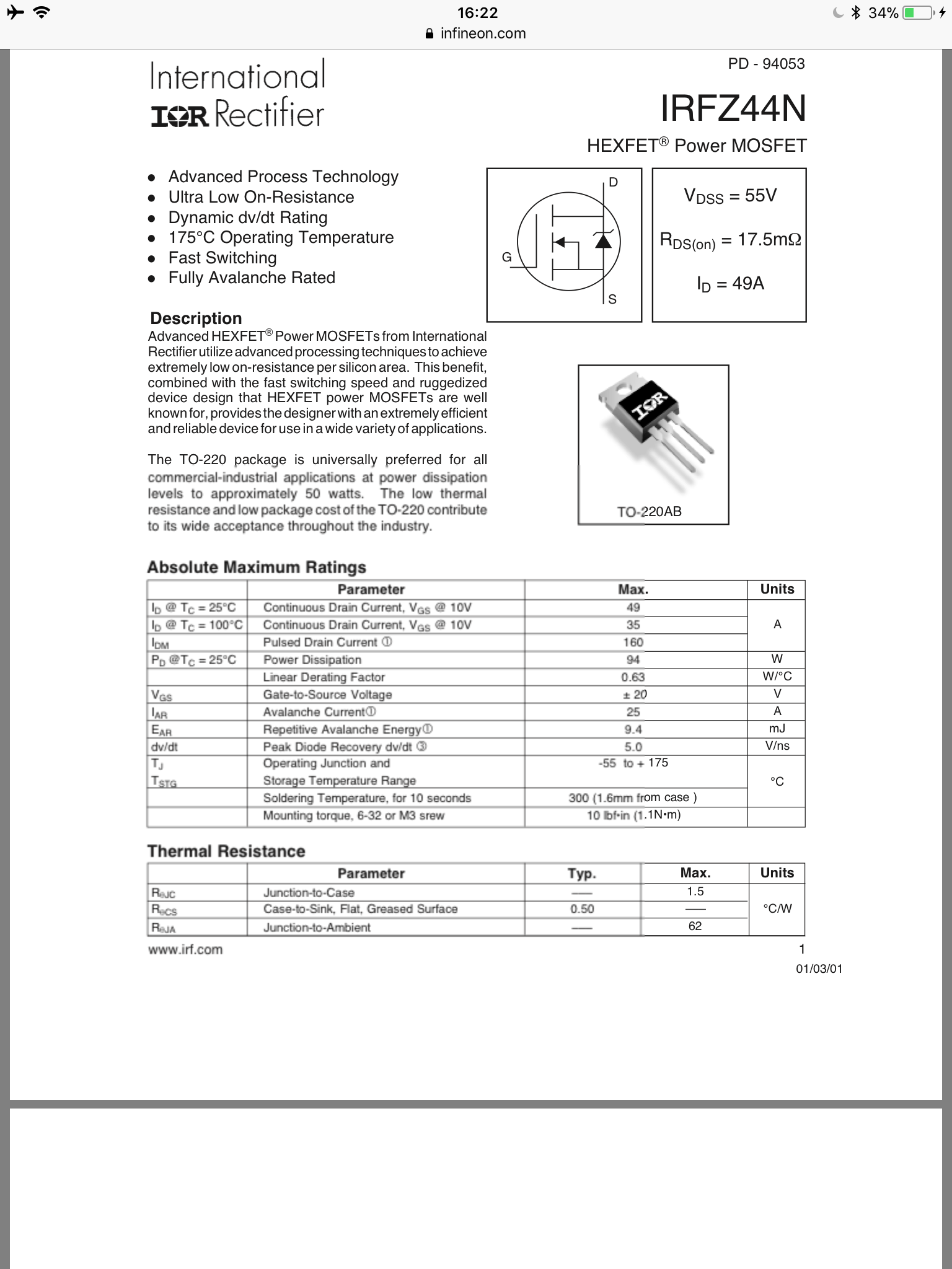

  9. I’ve a few of these laying about, do you think they will work for now? IRFZ44N
  10. Just looking at the prices of the fets you suggested, the cheapest place I can find ‘RS Components’ they’re £4 each, so if I replaced all 12 I’m looking at a bill of nearly £50! I might as well buy a 2000w controller from flee bay for £60

  12. Firstly, I know this is an Electric scooter but I’ve found this site really helpful with my bike and everyone on here is very knowledgeable, so I’m hoping someone can help out. My Chaos 1600w stopped working the other day, the motor would jutter a little as though it was going to spring in to action but would then stop. I stripped everything down and found that when the throttle is twisted and the motor tries to turn, one of the main wires to the motor would get very hot. Out came the multimeter... few parts tested and then the mosfets, first 2 fine next 2 not working, next 2 fine then next 2 not working, next 2 ok then next 2 not working, “I’ve marked the dud ones with a black spot on the picture”. Strange but may be why the motor will try to turn but doesn’t have the umf to do it. Obviously I’m going to replace them but I’m also thinking of upgrading all of the mosfets to prevent future problems but my question is this. If I upgrade them to a higher voltage will it A. Do any damage? B. Make the scooter quicker? C. Give me further problems? I’ve tried to include pictures of both the controller and the mosfets to give a better idea. Can anyone recommend the correct mosfets to change them with? Hopefully it only needs these replaced and not the whole controller £70!! Or I might just by a 2000w and upgrade everything. Thanks for any help
