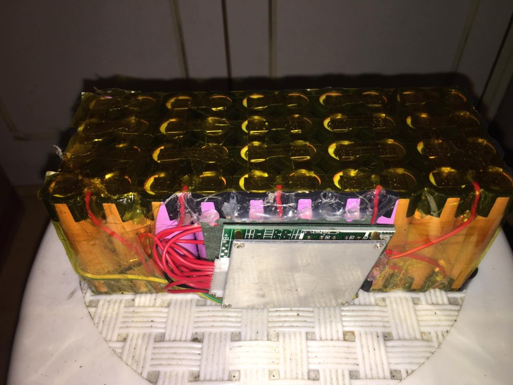

  5. Hello! I just opened a battery that is not charging now. It was working before. Currently the battery group which is at the POSITIVE SIDE is not showing any sign of life and i tried to recharge it separately - but without success... Thats how all cells looks like: - 4.21 4.22 3.55 3.34 4.21 3.66 4.14 3.38 3.25 0.00 + What you think about the case? Probably damaged BMS? Do you think that its good idea just to replace the dead battery group which is 0.00V and the BMS? Also the batterie looks discharged very trange... different voltages and different groups... not a few groups in a row, but in the above pattern you can see... What may be the reason for that ? The battery is used about 1-2 months and it was fully balanced.
