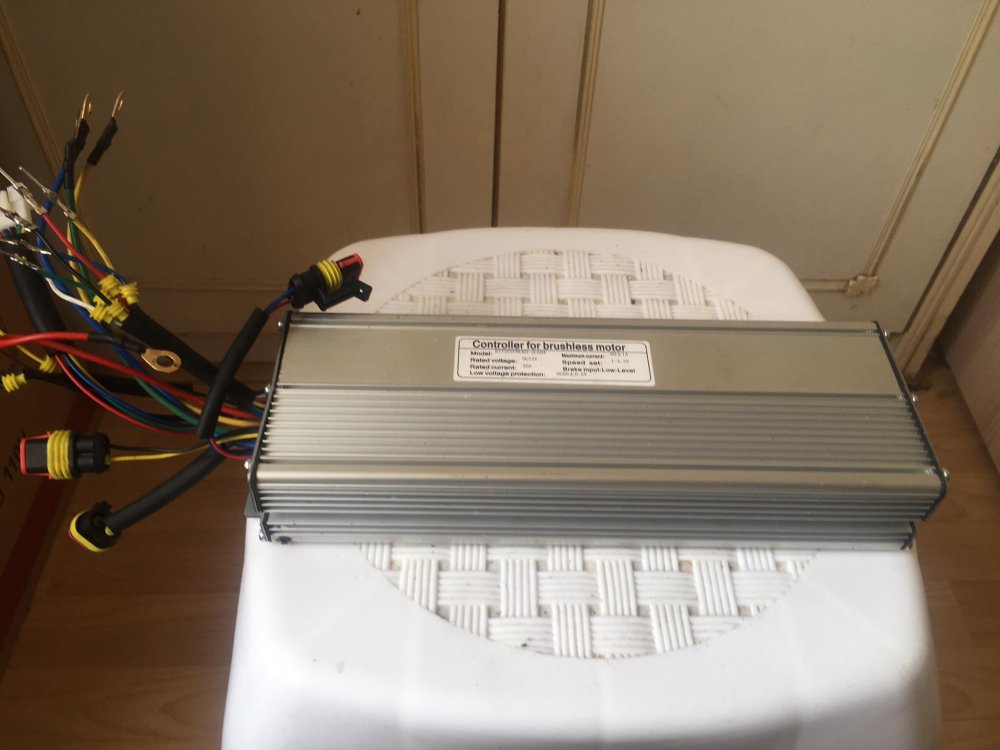

Hello! I am leaving the country in a few days - sunday 19th of May! EVERYTHING IS IN LONDON - BETHNAL GREEN So i need to sell everything i have. I have many tools and e-bike parts. Most of the tools are used just a few times, e-bike controllers are brand new, only the bluetooth(72V 40A) one is used 1 month. I prefer to sell all parts to one person, but in worst case i can split them. I will attach photos for everything, but i will not give detailed information here... its too much... PRICES: ALL TOOLS - 70GBP Drill, Battery charger, Rotary Multitool, Iron box, other iron, Heat gun, Glue gun, 2x Multimeters + ALL THE SMALL TOOLS ON THE PHOTO WELDING MACHINE - 50GBP ALL BIKE CONTROLLERS, AND OTHER BIKE SMALL PARTS - 150GBP (3-4 250W controllers, one with LED, another one with LCD, but it gives error, probably wrong controller with it. one 36V-72V(or 90V i cant remember) 40A bluetooth, and one KT controller with 2 broken transistors(by mistake i reversed + and -) ALL ABOVE THINGS IF BOUGHT TOGETHER - 200GBP I also have a few batteries - BRAND NEW(including chargers!), made by me and not used(only tested of course with 2-3 recharges): 36V 11A Chinese with 50x2200mah + BMS - 140GBP - FOR EXTRA 50GBP I CAN ADD CASE (or only 50 cells for 80GBP, i still didnt started making this one) 36V 12A SAMSUNG 3000MAH CELLS +BMS - WITHOUT CASE - 160GBP (FOR EXTRA 50GBP I CAN ADD CASE) 36V 15A SAMSUNG 3000MAH CELLS +BMS - 250GBP - WITH DOLPHIN CASE+MOUNT 2x48V 17.5A SAMSUNG 3500MAH CELLS +BMS - 350GBP/pcs - WITH HAILONG CASE+MOUNT one extra charger 36V 5A - 30GBP - BRAND NEW one extra 72V 5A Charger - 50GBP - USED I may also have a few used chinese batteries - but i have to check again. Total for all batteries+chargers -1320GBP, BUT if you get them all - 1200GBP I have and a few electric bikes for sell, and a few 250W 36V kits for sale. Message me for details. In depends of what u buy i may add some extra parts i have. If somebody is interested give me a call: 07480721813. Everything is located in Bethnal Green, London I can help with delivering if needed. EVERYTHING MUST GO IN 2-3 DAYS CALL ME: 07480721813
