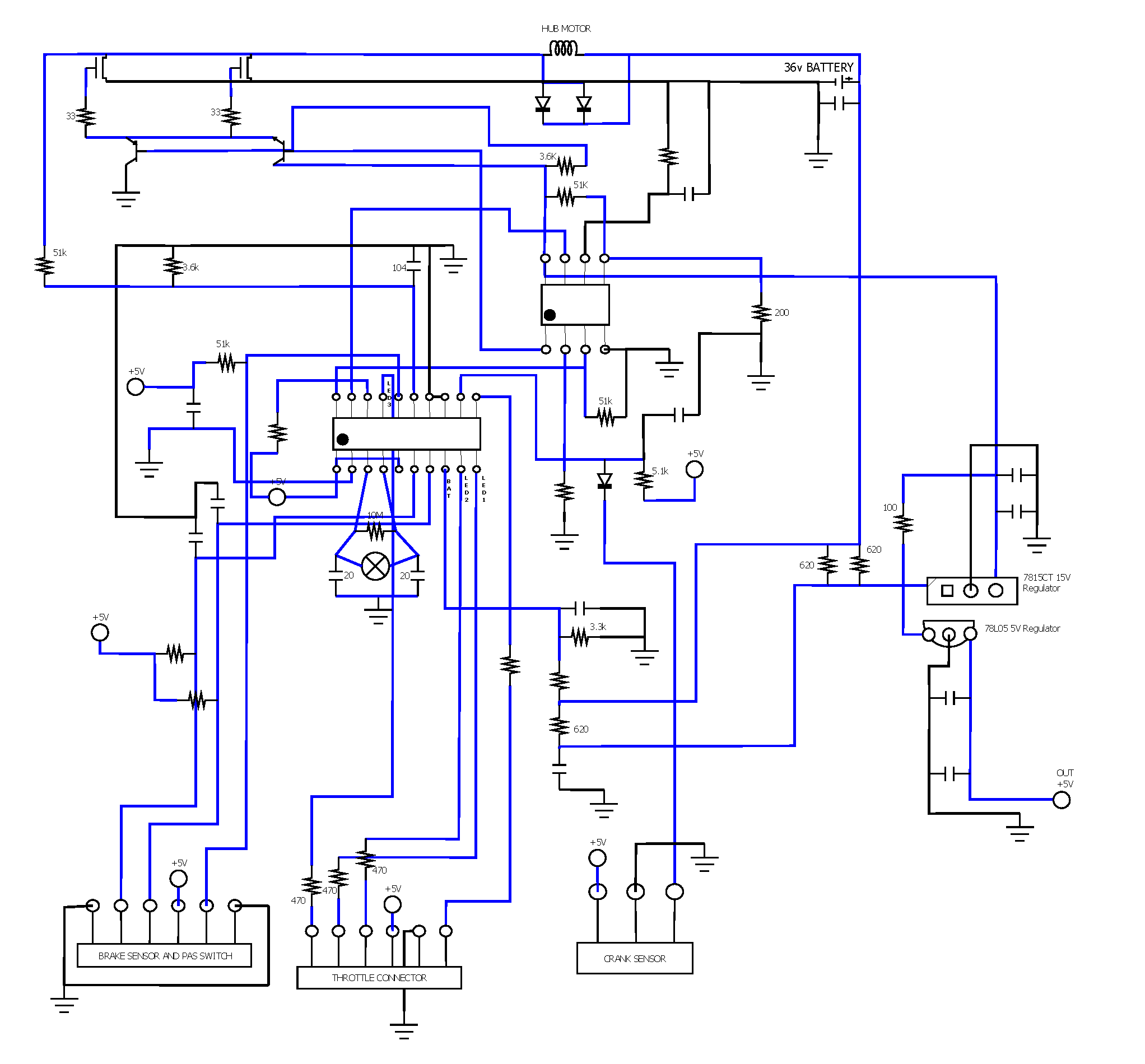

  1. Okay, So I believe I have managed to get this working in the end. I had to trace out the schematic, but eventually narrowed the problem down to two things. 1) A dodgy 5V regulator - generating 1.8v. (The controller board has two regulators on board, a 15V and the 5V) 2) A broken 16MHz crystal. Once these were fixed, I get the 3 lights when I turn the bike on (full battery), and it also passes all of the diagnostics. Just got to reassemble it! It could conceivably still not work, but from testing it on the bench it all seems to be fine. I've attached two files to this post, the first is the service manual from Powabyke, and the second is the schematic that I traced out. The schematic is not pretty, and probably has errors, but it helped me solve my problem, and may be of some help to someone else in the future. (Note: my drawing program doesn't have the schematic symbol for a crystal, so I had to substitute the symbol for a lightbulb). Also, thanks to wheeliepete for kindly offering to send me his old controller board. Cheers! Shopper 2002 Manual 1.pdf

  4. Yes, my mistake. I think I've spent too long looking at this thing . The wiring through the bike frame is actually prepped for a brushless motor, but at the hub motor and the controller they are shorting out two pairs of wires for the +/- of the brushed motor. I've checked both the mosfets and they are good. When I first turn the key, both mosfets are getting opened for a split second, which turns on the motor and causes the bike to jump. They then close, which is why the bike doesn't get permanent full power. The bike just lurches for a split second. Thanks for that info. You've saved me another headache if I end up replacing the controller. I've got an Arduino knocking around somewhere, but I don't really want to invest that much time in getting the PAS working. It's a nice feature to have, and I'd like to keep it, but if I can't get this board working then I'll just pony up for a new controller/throttle bundle. I think you're right about the processor/motor interface combo, with the smaller chip being the motor interface IC. I could probably get a generic motor interface IC after working out the pins. However, I can't identify the micro-processor. PICs have power/ground on PIN1/PIN20. The 20pin chip on the board has power to PIN7 and ground is PIN13/14. Thanks for the helpful info. It is v.much appreciated.
