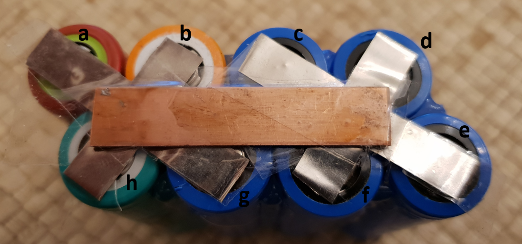

  4. I have done a quick mock up and looking at the layout the nickel strips will be a different length - is that bad thing?; a to g and c to e = 45mm b to h and d to f = 30mm If so as another option could i not use a bit of nickel sheet/foil that would cover the whole of the eight batteries in each S, like what KirstinS shows in her post (https://www.pedelecs.co.uk/forum/threads/hear-shrink-large-for-whole-packs.33604/) the holes/gaps look like they are just to align the nickel but it covers all 8 ends.
  5. I have just spent 30 mins giving the copper strips a salt and vinegar bath to clean them up - i will use some old cells and do a test build of #5 at the weekend.
  6. I like the H strip as it makes things very easy, and if it is double stacked it increases the capacity anyway. I can always do the second layer in the opposite (180 degree) direction so it forms multiple paths. Or if i go the copper way i have a bag full of these from a building job (12mm wide 15cm long and 1mm thick) which should do the trick. https://www.amazon.co.uk/Yvens-Decroupet-Copper-Tingles-Roofing/dp/B01N5VRU10/ref=sr_1_4?ie=UTF8&qid=1547558905&sr=8-4&keywords=copper%2Bstrip&th=1
  7. Its for a BBS02 750w 48v using 10A cells (https://eu.nkon.nl/rechargeable/18650-size/lg-inr18650m36-3600mah-10a.html), I would have preferred a 15a cell but this job is prioritising distance over power. Every good job starts with a jig so i am up for this I can double up the Nickel X to allow the 10a battery to behave as it will be only a little extra effort. Good point about the wider bus dissipating heat quicker, it also helps with packaging up once complete a it keeps the overall thickness of the build down.
  8. That makes sense, I have some of that H strip left over from a previous job and 1.5mm twin and earth has a 20a rating which would be fine (and it is insulated). One thought i have also had is about grouping the batteries in squares of 4 (red squares) and then joining them (blue dotted lines) with double thickness nickel strip, that would make it easy to do odd shapes.

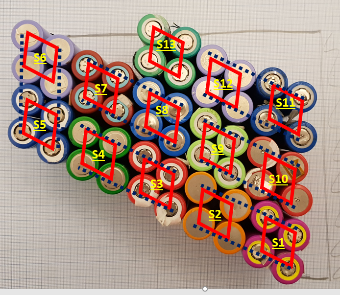

  9. I have got a tight space to fit a 13S4P into and have been messing around with layouts for a while and i think this is my best option. I have two thoughts on connecting S11 to S12, one is to put an extra thick layer of insulation over the ends of the cells in S10 and S9 so i can lay nickle strip between S11a and S12a etc - or to use a decent gauge wire which is already insulated and solder that to a piece of nickel, and then spot weld the nickel to the battery? The batteries in the picture are for illustration only
