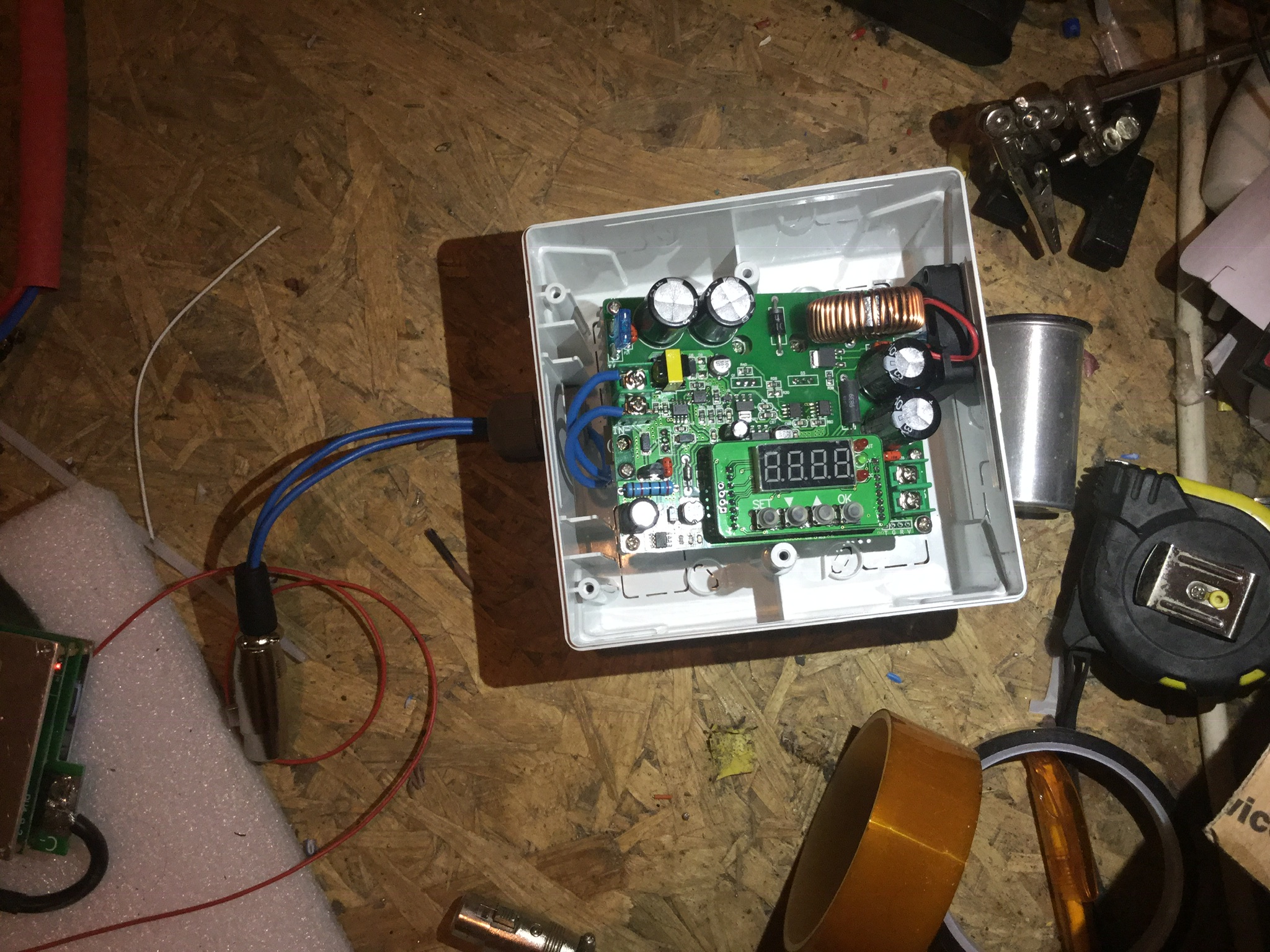

  6. I believe one of these digital buck cc, cv, power regulators could bring a battery up to voltage. However, without specific monitoring of each parellel cell group not something I would try.
