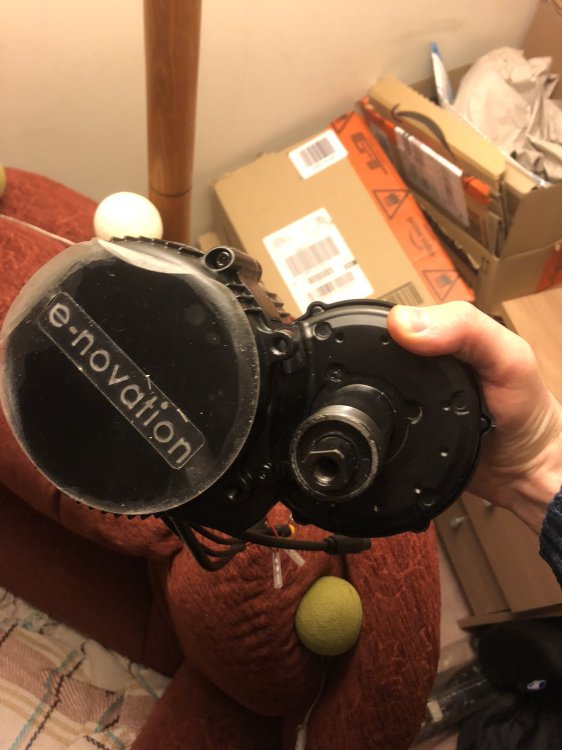

Oh wow, that's a fantastic resource thank you! Don't know how I didn't find it before One more thing though, which I couldn't find in that faq (although I've only skimmed it atm) - how much resistance should there be when rotating the pedals with the motor off? I read that there is a clutch of some sort between the pedals and the motor, so I thought it should be fairly easy to turn. Maybe not like a proper bb, but similar. But mine is, not exactly stiff, but not loose either. For instance, if turned to horizontal (with no chain attached) gravity is not enough to turn it vertical. There is a fair bit less resistance when pedaling backward however, and gravity is enough to rotate it in this direction.

Ah yes! Checking the grounds is a great idea, thank you And thanks Nealh, I assumed those were the wire assignments, but it's good to have it confirmed. Assuming it works fine, is there any preventative maintenance I should perform before fitting it to the bike, such as greasing gears or waterproofing? I know the 'B' version was supposed to have improved waterproofing, and I will definitely be using this in some heavy rain.

Bought this BBS01 from eBay the other day because it was cheap. I want to test it just to make sure it's working, but I don't know what the polarity of the battery connector is (I presume that's the two pin one at the bottom in the photo..) Would anyone be able to help me figure it out? I could cut into the wiring, but a) even if the wires are red and black I couldn't be sure they didn't just mix up the colours, and b) it would make it more difficult to return if it didn't work I'm thinking I might have to disassemble the housing to follow the wires inside? But I'm worried that would involve disturbing some sealant or something
