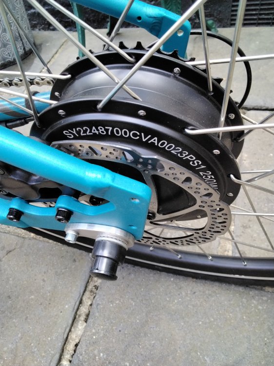

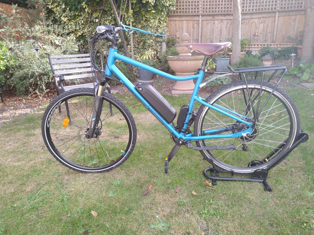

Hi I find myself having to sell my ebikes due to medical problems and would appreciate any advice on valuation First is a Woosh 48v DGW22 kit built Apr 2022 on a brand new Riverside 900 , large frame with only 192miles recorded Landcruiser plus reflective tyres Brooks B17 Special saddle, original available Original rear wheel Ergon grips Dual torque arms front & rear lights Hornet Siren Photo's attached Also Fiddod D4S bought last year, 100 miles only, upgraded discs with genuine Avid bb7 front caliper. Controller and display upgraded to KT kit Photo's to follow BBS01b on an immaculate Large Specialized Crossroads 2015 model. Converted to front suspension Suntour forks stiff springs and hydro lockout & A headset New Mach 1 wheels New Tour Plus reflective tyres Ergon grips Books B67 sprung saddle Quality mudguard, rear carrier Spare chain Bafang tools Programming lead Tubes of Mobil 28 grease Built Oct 2020 1180miles Photo's to follow
