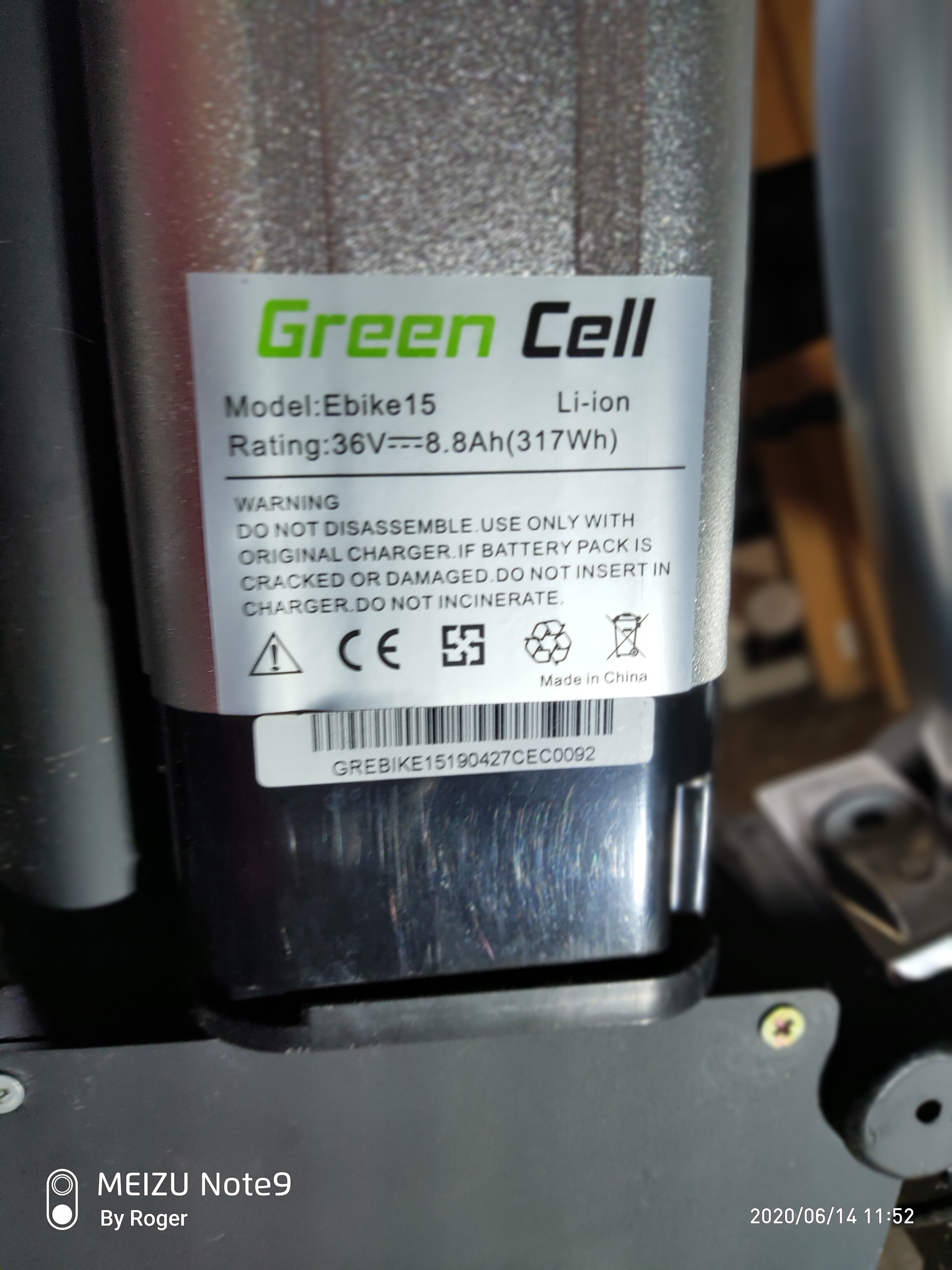

  7. Thanks for reply. Yes, the old batteries have been ditched. New ones are 36V, 8.8Ah and 36V, 7.0Ah respectively (gents', ladies'). Both show same symptoms, at any speed. Uphill the motors sometimes groan, and cut out much more. First pic - gents' handlebars, 2nd = ladies'. I weigh 72kg.

  11. The mystery for me is that the 'old' lead-acid pack (I stripped it apart) comprised 12 metal-sealed cans plus a load of electronics. If I use 3 12V SLAs, what about electronics? Will I just then have throttle-control? Will the motor be ok with such an arrangement?
  12. Several months ago I was given 2 old electric bikes from a recently-divorced friend who no longer wanted them. They are Zoom Swift140 model, gents' + ladies'. Can find absolutely no info online. Friend thinks they are 10 years old. Both hadn't been used for years and both had totally duff batteries. I reasoned that new batteries and I should be up-and-running. Well, yes and no. Each battery pod looked similar to many I had seen advertised, so I bought two new packs, one 7Ah and one 9Ah. My wife and I are both well-retired and just want to poodle around for maybe 10 or 15km, couple of times a week. Both bikes are certainly pedal-assist and both also have twist throttles. Both bikes are in excellent condition. It turns out that the original batteries are lead-acid and of course the new ones are Li-ion. What is happening is that the drive is erratic - on both bikes it's the same - you get assistance with cuts for a couple of seconds - riding on flat is better - and throttle position makes no difference. Any twist activates power (mostly) but altering the twist makes no difference. I am now pretty sure the motors aren't happy with the Li-ion power delivery. Question is, of course, what can I do? The bikes are too good to throw, but I now have 2 new batteries of the wrong type. I have searched high and llow for a solution, but found none.
