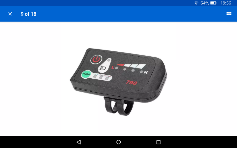

  7. Please help I have purchased a new led display to replace my old worn out button one. The old display had 5 wires Red black blue pink purple which corresponds to the controller. My new display has 4 wires Red black blue green. I have connected them up like this Red/red black/black Blue/pink Green/blue And have the purple wire over! Everthing works (including the throttle) accept the PAS. Now matter what speed (low med high) you put it in it doesnt change. I tried Blue/blue but the throttle didnt work. Any advice please?
  8. I am replacing my worn out LED display with a new one which has a light switch fitted (see attached) The LED display has yellow + and brown - wires coming from it for the lamp. Previously the lights was wired directly to the battery so came on as soon as you turned on the 36v battery so they were on all the time. Is it just a case of connecting the light the the positive and minus wires from the LED controller?

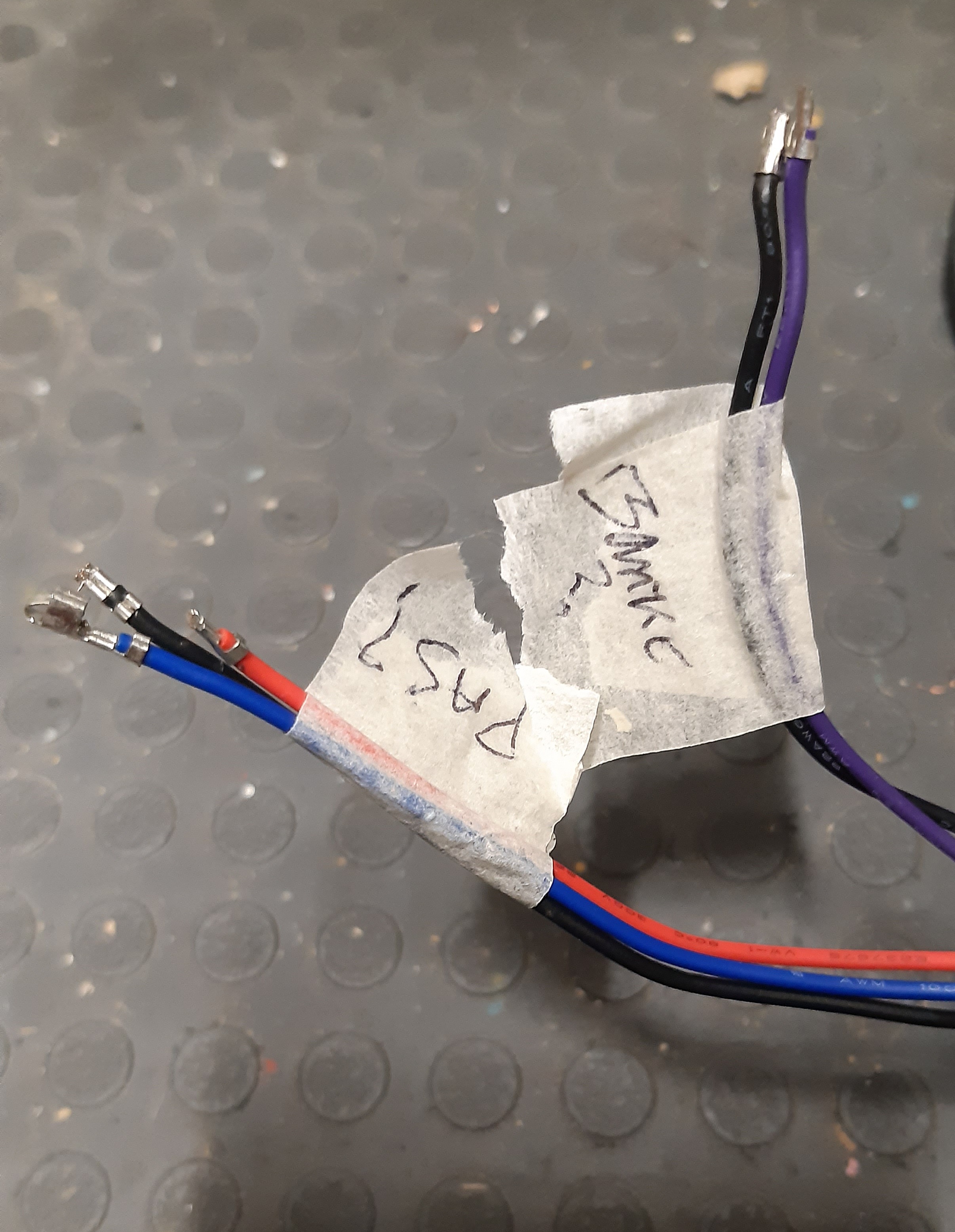

  13. Ok I have connected everything up except the following. PAS has black red green wire Brake cut out has black red wires Coming out of the controller I have X2 blacks red purple blue Wires The bike is also fitted with 36v lights so I dont know if the controller caters for those the previous owner had them on all the time as soon as you turned battery on so were not connected to controller. First image shows wires coming from controller
  14. Does anyone have the wiring diagram for my 36v Controller for a 250w motor P/N 3615dlc-10y0 Its from a Pro Rider E Tourer ebike I am restoring and someone has made a right mess of connecting the wires. I thing they are also installed in the Wayfarer Pro Rider bikes. Thanks in advance
