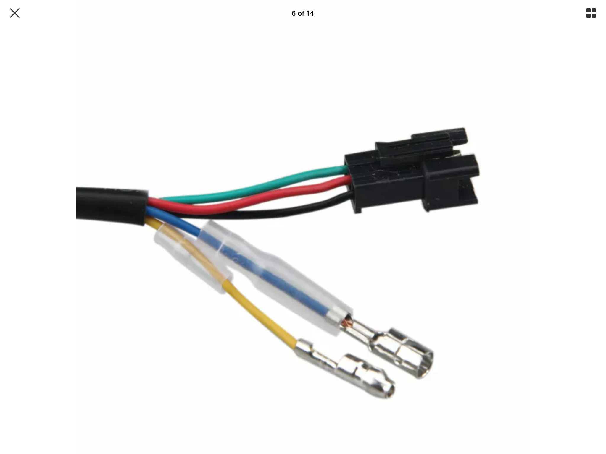

  7. Please help I have purchased a new led display to replace my old worn out button one. The old display had 5 wires Red black blue pink purple which corresponds to the controller. My new display has 4 wires Red black blue green. I have connected them up like this Red/red black/black Blue/pink Green/blue And have the purple wire over! Everthing works (including the throttle) accept the PAS. Now matter what speed (low med high) you put it in it doesnt change. I tried Blue/blue but the throttle didnt work. Any advice please?
  8. I am replacing my worn out LED display with a new one which has a light switch fitted (see attached) The LED display has yellow + and brown - wires coming from it for the lamp. Previously the lights was wired directly to the battery so came on as soon as you turned on the 36v battery so they were on all the time. Is it just a case of connecting the light the the positive and minus wires from the LED controller?
  9. Thank Neah I have ordered a new control panel (see below) which has a light switch. will the yellow + (brown -) wire that come out of it have power for the lights?

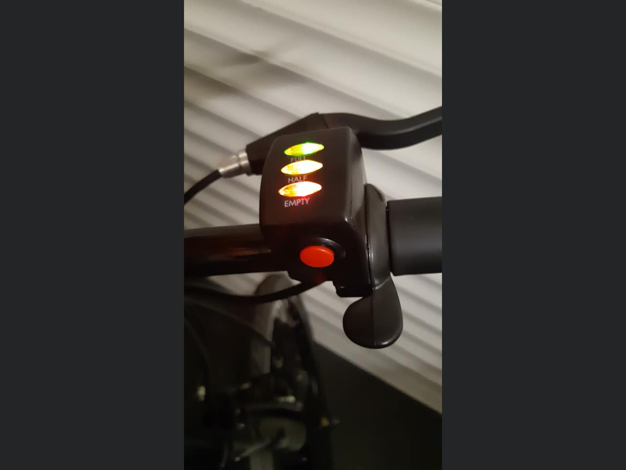

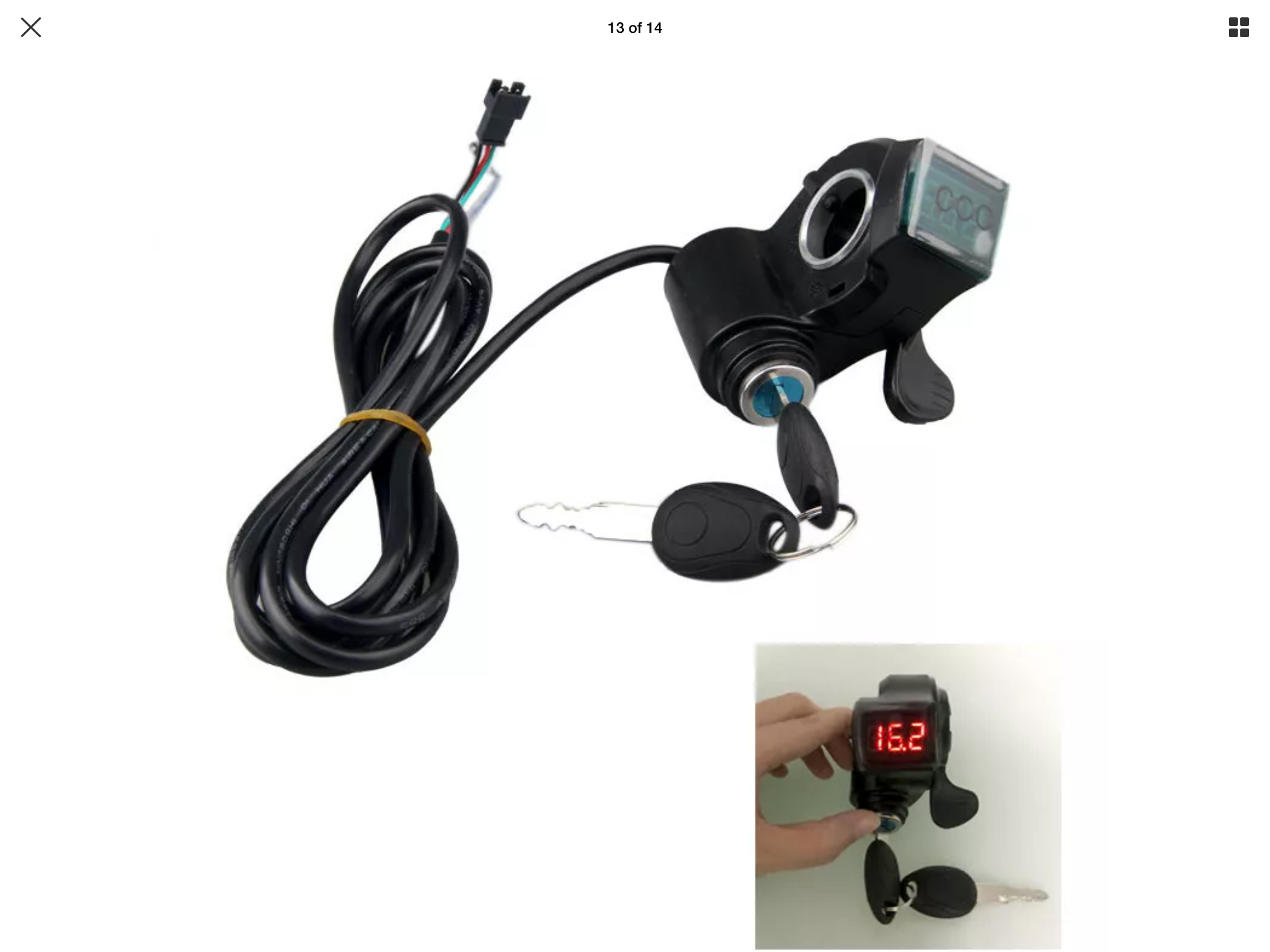

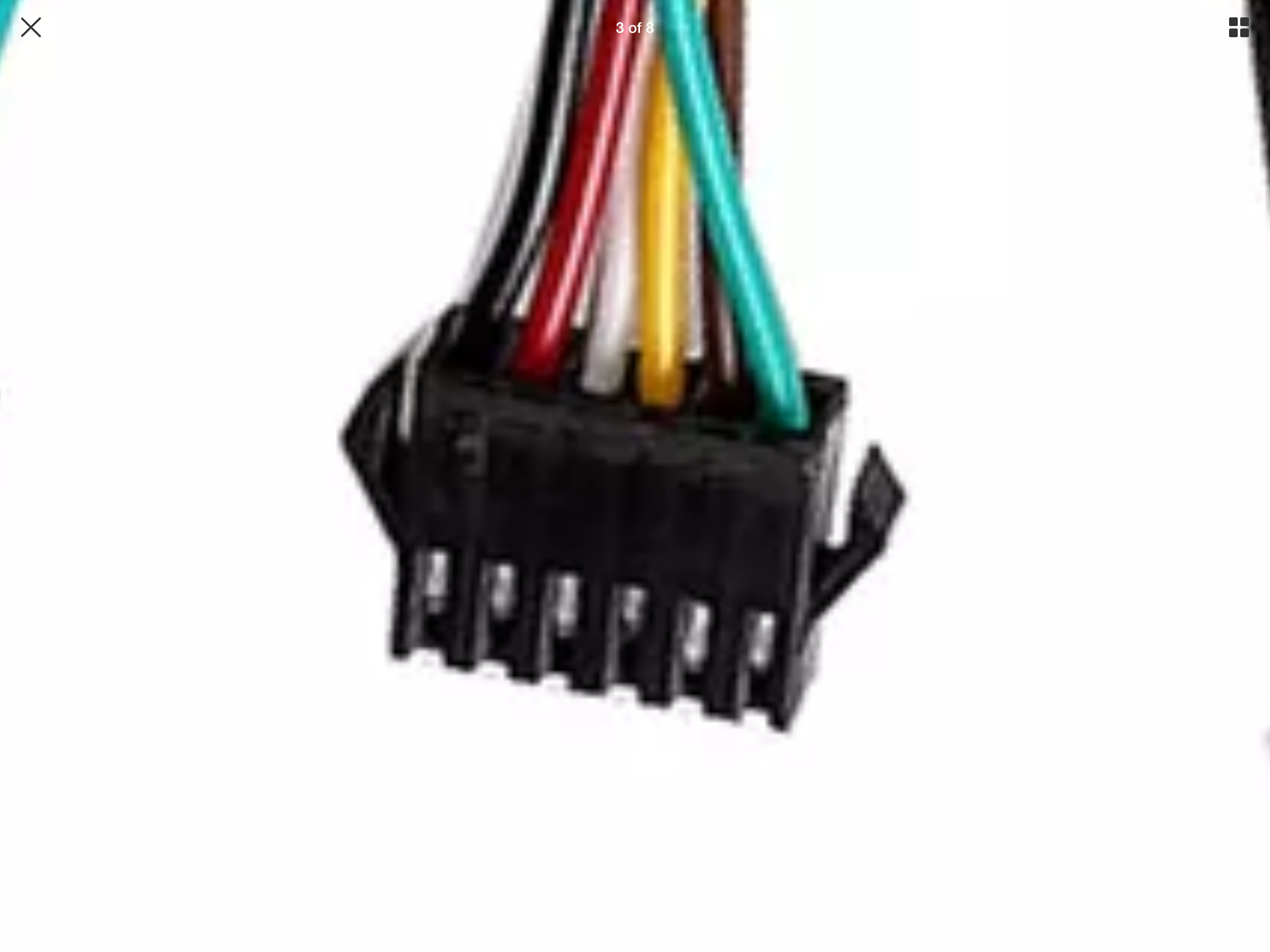

  16. I would like to change my Thumb throttle which currently has an on/off switch and 3 led battery level indicator lights to a key one to stop people from switching it on when I’m not about ie parked outside shops or pub. The only thing is my current thumb throttle has 6 wires going into the controller connector and the one I want to replace it with has 5 wires! Can this still be done? See photos below.
  17. Unless I can change the thumb throttle to one with a key? My current thumb throttle with 3 led power indicator and on/off switch has a 6 pin connector, the key throttle one with a key and voltage meter has 5 wires, how can I change it?
  18. That’s why I wanted a switch to cut the battery power. Every time I leave the bike to go in shop or pub people can mess about with it unless I disconnect the connectors every time which is a pain.
