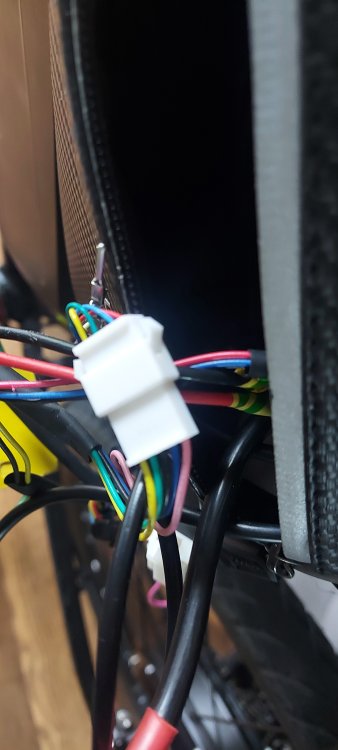

Oh I see so maybe I didn't need new pas after all as I think I must of connected them the wrong way my throttle is green red and black as is the wires on controler I just presume they whent together my pas wires are g/r/b so they go to black red and white I'm presume sorry for al the questions but out of everywhere I seek help pedelecs are the ones giving correct and accurate information thanks for your help have ordered some connections and will try tomorrow andet you know cheers

hi i have tried wwiring pas but still nothing I must be doing something wrong could you please tell me which wires to connect where please it would realy hell me out don't really have much knowledge of what goes where thank you

Hi all hope everyone is good I have a wiring issue I have built a 1000w 48v rear hub drive mtb the kit is a gvolt kit when I fitted everything the pas never worked so I bought a new butthe wiring is different colours I realy only want to throttle off road as I find its to much for daily commute any help would be much appreciated

Hi all I have just converted my carrera hybrid in to a rear hub drive I have a kt-lcd9 display with thumb throttle purchased with controller and pas my problem is there is a white wire coming of display it is separate from 5 wire plug and no idea where it goes and I can't find any parameters settings anywhere pas is okay but would like to use throttle once in a while I have zero experience in wiring so any help would be much appreciated
